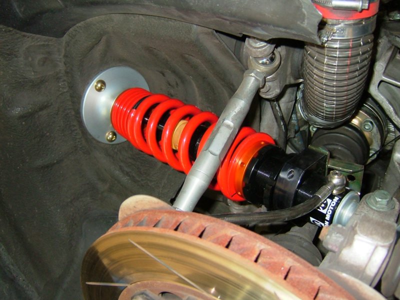

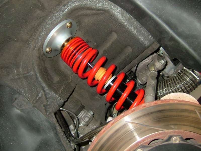

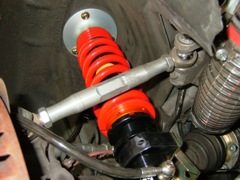

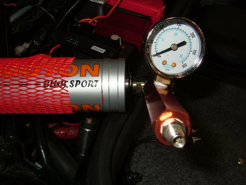

Just when I thought it was safe to never mod my darned car anymore...
OK so I'm now on number 18 suspension kit for my car However with much sadness I kissed good bye to my track-proven JRZ set up (a local customer wanted them THAT bad lol!). I'll miss the JRZ set up for sheer aggressiveness but the set up that I'm going to is a very tried and tested Moton ClubSport set from EVO. It makes a lot of sense since that's what we seem to install a lot of the time. I've always felt the PSS9 kit isn't quite good enough for the 996TT. It's just underdamped and the spring rate is too soft for how heavy the car is. Then when you stiffen the shocks all the way it starts to over-power the springs and bobbles around all over the place. If you can swing it (price-wise), more and more of us Bay Area turbo guys are going Motons. And before any of you say "Oh it's too harsh for the street etc...". Absolute cobswallop! Most people I know that have started with PSS9s and then continually stiffended them up before switching to Motons now say. "Man, I can't believe how comfy the ride quality is". It's very flat and not harsh either. The springs/shocks are well matched for the weight of the car to put it in laymans terms... There are plenty of different options for the springs so I can go over that with you guys if need be. And don't worry we can always charge/recharge and check pressures for you but the way these new seals are I've never seen them leak. You can see the last pic where we're charging them with nitrogen. I'll show you some more pix later today but the camber plates that come with the kit also allow for another degree of camber in the front. The new billet clamps are pretty nice too if you have a roll bar and/or strut brace (I'll show you thsoe later).
So in essence if any of you in NorCal are thinking of doing something suspension-wise, my car is always at the shop and you are welcome to try it out anytime. You pay for your own C16 and Speeding Tickets tho...
This is the kit I'm using in detail: http://www.sharkwerks.com/products.php?pid=22
