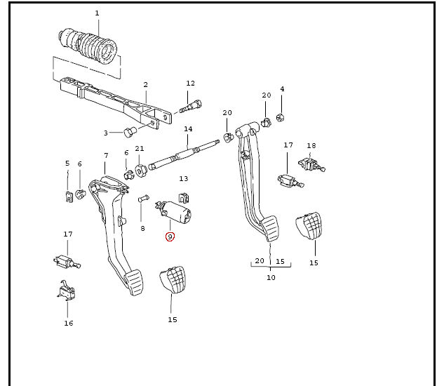

can anyone comment on removal of the clutch power spring ?
specifically, how much stiffer is the clutch pedal? is it more/less stiffer than a gt2 setup?

Here is a pic...you remove # 9. Thats the helper spring. I will warn you watch your eyes when taking this out, it wont kill you but might hurt a bit

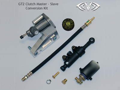

Evoms has a GT2 conversion kit. $980.

here is my update.
I had all the assist thrown away. But still have some issues. Probably due to the clutch etc. So I ordered all gt2 parts and it came out to be $450 with my dealer discount. It includes the master slave, the slave cylinder, the clutch spring and the hose that connects to the slave. I should have it installed Saturday.
Markski
Much better deal than Evoms.
Remember, the GT2 uses brake fluid not power stearing fluid to power the clutch. You need to clean out any existing parts.
