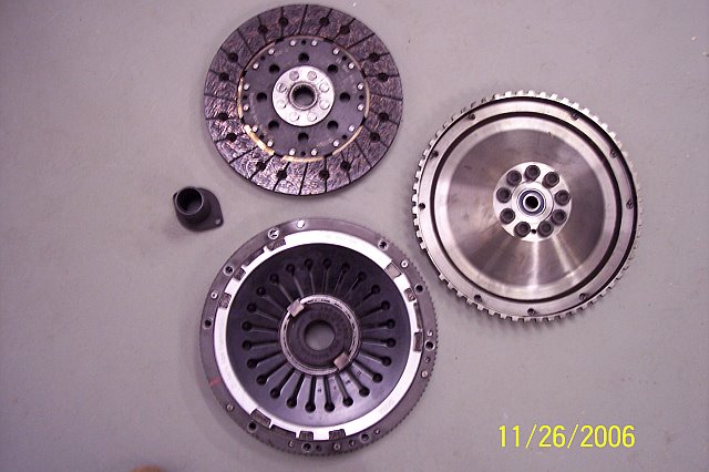

I've been offered the following used setup:
Flywheel Assy: ZF Sachs Race Engeneering, part # 88 3082 999 752
Pressure plate: Sachs, Made in Germany
996.116 015.88
20.1864 531 802
Does anyone know how this compares to the GT2 set being offered by a couple of tuners for $1800?
Pics:

The 3082 is good up to the 640 kit. To give you an example we will use this pressure plate then build it up. It is a good setup and will hold more than the stock units.

So would you say it is better than the $1800 set or no? Just trying to put a value on this.

go for a sprung clutch disc like the gt3rs one

We offer
Double plate tilton ,
Triple plate tilton
Triple plate sachs racing set up..
How crazy do you want to get. All come with a flywheel..
www.gmgracing.com
All are available with a lightweight flywheel.
These are "real" racing clutches and not glorified street clutch kits.
We do have a street clutch upgrade also which is similar to what most sell
Includes a GT2 style disc full faced not sprung- Sachs Race Engineering Pressure plate- T/o and all neccasery parts. This will work with our lightweight street Aluminum flyhweel ( 11.5lbs) and or with the stock dual mass.
