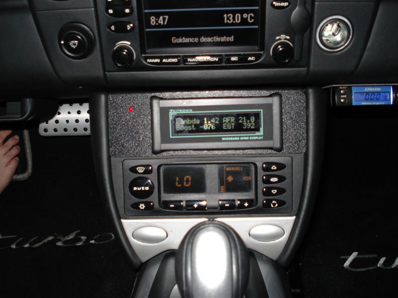

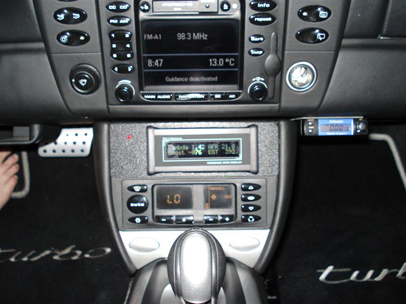

Guys
I took Deputy Dogs advice and purchased the Zeitronix Gauge. It displays - AFR, Boost, EGT, ect.... It's also a Data Loger so you can hook your laptop up to it and see the readings by themselves and plotted with each other.... I was just out toying around with it and its amazing! I was able to go out and do a couple of quick spirted WOT's a 1.3 Bar and come home and analyze the AFR's and EGT at the point when boost changed higher or lower.... The Boost reads in Bar and or PSI... Also, you can customize the display on your laptop to only graph the data you want. You can plot data like: RPM, EGT, Lamda, Boost, AFR and others that wont be displayed on the main unit in the dash....
The Digital display that was mounted in the console works great! Its very bright, resposnive and easy to read while glancing quickly and driving at the same time... The Boost was 100% accurate or at least dead on what my Greedy Boost Controller was reading! It also came with a small LED light that was mounted next to it that can be set as a "Warning" light and buzzer when a specific reading goes to high or low.... This is great for AFR and Boost, you can adjust all of this with your laptop, this would be ideal for a track day when you are watching the track and not your aftermarket gauges!
The whole set up with Digital Display, Harness, Data Box, Trigger/Warning light, EGT Probe and bungs for the headers came out to like $650.00 shipped. The install on the other hand was pricey, but worth it as I wanted a clean install not only with the unit but the wiring and welds! To do it right and relocate the NAV CD Slot, relocate my Greedy Boost Gauge, weld the EGT bung in the headers, run the wiring for the AFR, Boost an EGT into the car from the engine under the carpet, through the consoles and into the center dash and make a mounting bracket cost me $800.00. They honestly had over 14 hours of labor but only charged me for 8 hours becuase this was the 1st set up the had done using the Zeitronix. I am sure that the next job could be done in 6 hours now that they have a blue print on how to do it...
Overall - Its a GREAT unit! It will come in very handy at the track to be able to analyze the data when the car is stopped or at home using the laptop!
I HIGHLY suggest it!

Why does the bezel look so cheap is it just the flash?

Is that a Greddy Turbo Timer I see??? Thinking of adding this device, but some seem to believe warm downs are unnecessary.

thats is the Profec b spec 2 boost controller... Its not a turbo timer...
Its just the flash! The unit and bezel look great in daylight or without a flash... It was just to dark tonight to take a pic without the flash.....
