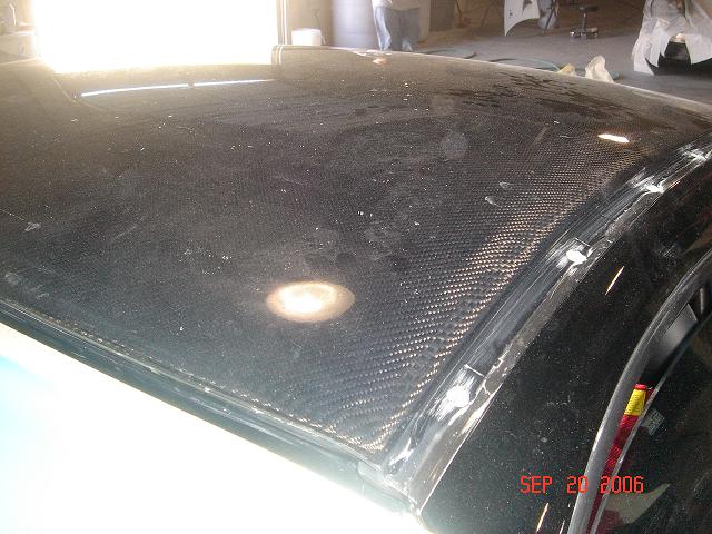

Originally Posted by tradin1
Wow, this is exactly what I've been wanting to do. My sunroof does nothing but rattle, steal headroom, and **** me off!
How'd it work out, any fitment or other installation issues? Is a carbon roof safe for street use? Would it break up in a rollover?
Yes, it will break easily in a rollover. The sun roof can be removed rather easily. The cost of replacing the headliner is steep.
