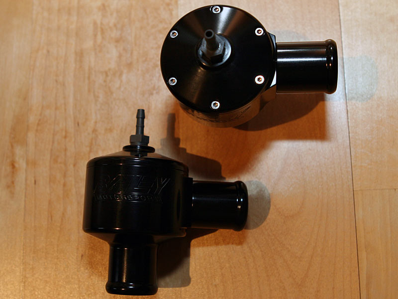

A picture of my valves:

They should be able to swap those out. All the need to do is match the threads and try to find the 90degree elbow version of that valve fitting. I have them on my car and, although I didn't do the install (On the car when I bought it), there's plenty of room in there...

all you need to do is change out the nylon fitting to the 90 degree version. ask mike@awe he has the correct fittings.

If you look at the top of your valve it looks like the connection would unscrew and you could just pop a 90degree elbow in there instead, this is not difficult at all, bread and butter!

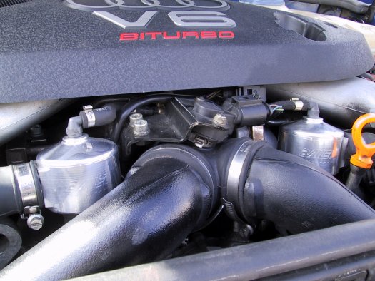

Look, here is a quick pic from Audi Turbo with Baileys, look at these connections, this is what you need! Source these!

Yeah...I know, but since he insists on saying that I'm his only customer with this problem I first need to prove he's wrong...
If i just get the 90 degrees nipples I can swop then out myself.
