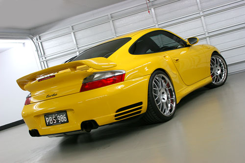

If you want to see something a little extreme, this car
runs 245/30/20 & 305/25/20
Horribly over geared, which detracts from its acceleration, but still no ABS / PSM issues...
