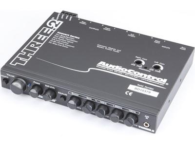

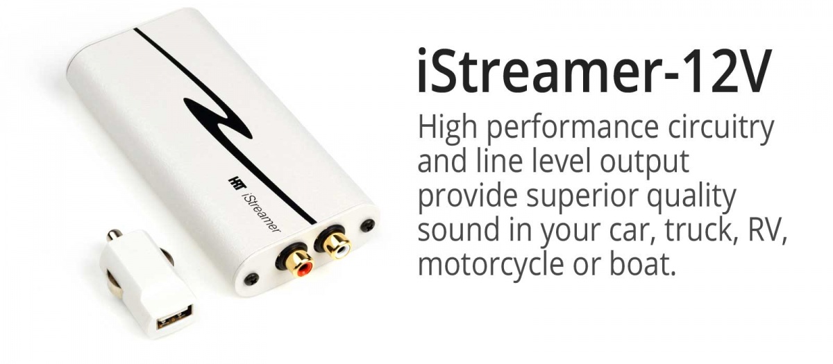

If you want to skip the head unit, you'll still need an amp so I don't think you'll have much weight savings, but you could go:
  • iPad -> headphone out -> Amp in. Volume control would have to be on the iPad, sound quality would be so-so.
  • iPad -> iStreamer (usb DAC), -> Amp. Better sound quality, still no rotary volume control.
  • iPad -> iStreamer -> Audiocontrol 3.2 preamp -> amp. Great sound, rotary volume control, but I'm not sure it would be any better than just using the pioneer receiver for the USB charging / DAC / Pre-amp functions.
I really liked the idea of completely eliminating a conventional head unit, but it was far more expensive and complicated to 'go lean' than just buy the Pioneer.
