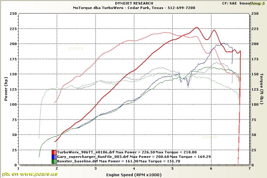

I have the Turbowerx kit installed on my 99 Boxster.
Attached you will see my stock dyno and my turboed dyno I got the 60ish horsepower increase with a large amount of low end tourqe.
The turbo is intercooled and I am running 6 psi.
