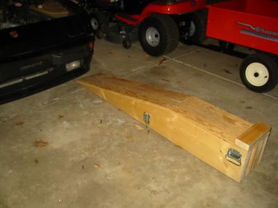

Originally Posted by Euclid
You know that "lip" at the entry to most garages?
I back the car so the wheels are just on the upside of that lip.
Wow, that is a great idea... There is almost enough clearance to get down there when the car is flat, so this would be just enough to get it done.

I just jack it up and remove the drain plug, then let the jack down with the car over the drain pan.
What are you using as a jackpoint?
jackpad right in front of the either rear wheel (just one side). jack it up a few inches (3-4) just enough to get your arm under to loosen the drain plug, put drain pan under and then remove the drain plug, lower car.
I use the same technique for the filter.
good luck and be careful.
Do you jack it up from the center of the rear, or do you use the regular jacking points, which lift up just one side at a time?
I don't even use ramps.
Gives me enough room for a drain pan.
Easy peasy
The lip at the entry to my garage is less then 1/2", so that's probably not enough. But is the only consideration whether the drain pan will fit under? In that case, if you found a low-profile drain pan that fits 9 quarts, would that do the trick?

Originally Posted by Oggie (on L.I.)
Do you jack it up front the center of the rear, or do you use the regular jacking points, which lift up just one side at a time?
regular jacking points, i do the right side since the filter is on that side too.
