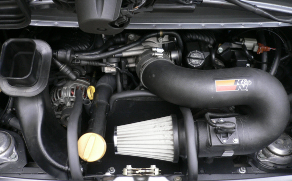

I have this kit as well and I do like it. I've had it for about 5 years,some pointers. I changed the filter to an AEM Dry Filter. I was sick of getting the CEL on and it fried my MAF from the oils on the filter. Ever since the filter change no lights and still same sound.I also agree it's a pain to put together,putting that rubber/metal trim around the box could really be done at the factory for the price we pay for it! Enjoy.

I installed the K&N too.
The install was annoying but I love how it sounds at WOT past 3K... Not sure I can tell a difference performance wise but I don't have plenum/exhaust yet.

These intakes don't make a performance difference on the car. The air filter piping and filter isn't a restriction in terms of the engine lacking the air it needs to make power. The sound of them is great however. They do suck in hot engine compartment air, so at low speeds they rob you of power. At higher speeds, the hot air gets flushed out so you're not hurting your performance.
Before anybody says "But you have a Turbo" I used to have an NA 996 and I did a lot of testing with an intake and measuring temps with a point and shoot gun and determined the temps were higher where the car was pulling air from.
