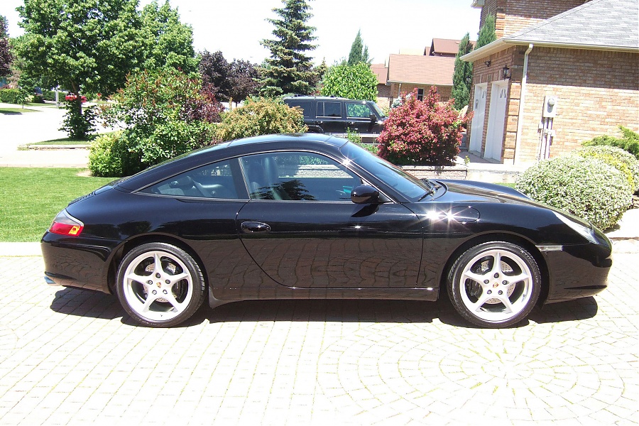

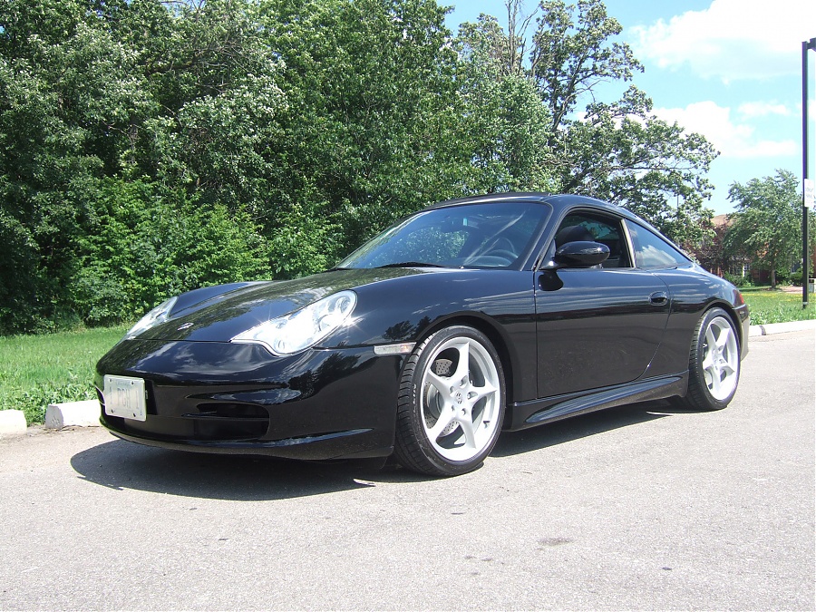

Originally Posted by vividracing
Glad to hear Pete. Please post up some pics!
Before and two after pics attached Dan. Thanks again for working with me to get the 9's to Toronto. This set-up is amazing. The car really does stick to the road now.
Got a chuckle out of my other half a couple of days ago after nailing a corner just right "... holy crap Pete, I thought you were going to keep turning right into the oncoming lane of traffic ...."
