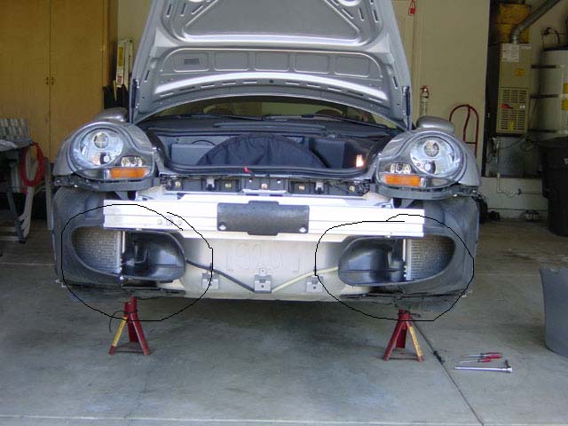

The only mod you might have to do is cut back the bumper mount a few inches on either side. That's the bar that goes across the front. The TT bumper will fit ok, but since the mount is longer you would see the ends of the mount thru the TT grilles. A TT mount costs about $600, but cutting the stock one isn't a problem. The air intake ducts do not have to be changed.

I swapped out mine also:
$600 for a used bumper-I've seen them as low as $500 and as high as $900
$380 to paint
$280 for clear bra.
No mods necessary. The body shop was able to save the eyebrows and re-glue them. With regard to the old bumper mount, have the shop spray it flat black and you won't see it. Then if you want to put back on the old bumper, no problem.
