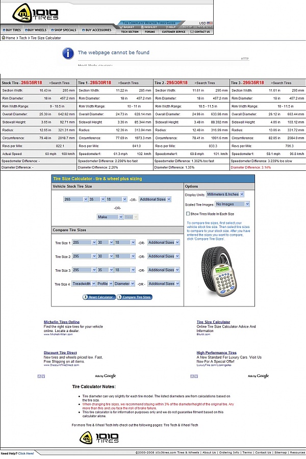

Here are the tire size and offset calculators: http://www.1010tires.com/tech.asp
http://www.discounttire.com/dtcs/infoTireMath.dos
The 295/35s are going to be too tall IMHO. The correct size would be 295/30s. I run 295/30/19 with 11" rims and think the 35s would rub. The offset should be fine they are only 2mm different. Use the calculator to get the exact info.

The results
TDK
PS: Too small go to the website.

Sorry, right now my rears are 265.35.18 and they clear well with no rubbing... so I don't know if 35 are too tall for my dream size: 295.35.18... but I never know...
Thanks for the chart!
