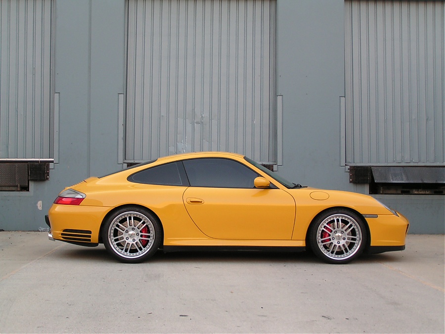

I'm nearly certain that the clanking/clunking sound is coming from the smaller spring. But if it is in compression why the movement and sound? I'll look into it further later this week with a wll informed Porsche friend/mechanic. Here's a recent pic of my ride...
