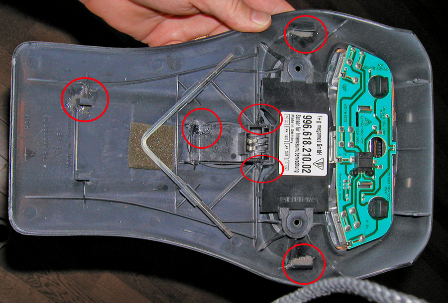

Cover just pulls down, but on plastic of this age expect some damage to the mounting clips. In the attached photo I've circled the areas that I repaired to address the same 'loose switch' problem; used 2-part epoxy.

well i pulled the rear-most tabs (without breaking them!) and repositioned the switch by sliding my hand in. Will need the epoxy as stated in post above, because switch mounting tab is indeed broken.

If you use a very small flat head screwdriver you can pop out the clear lenses that cover the dome lights. Once the lenses are out you will see two small screws to remove and then you can easily remove the entire piece. I did this fix about 6 months ago and used super glue and it is holding up great!
