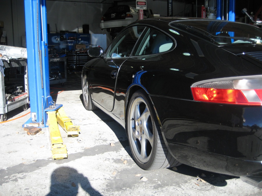

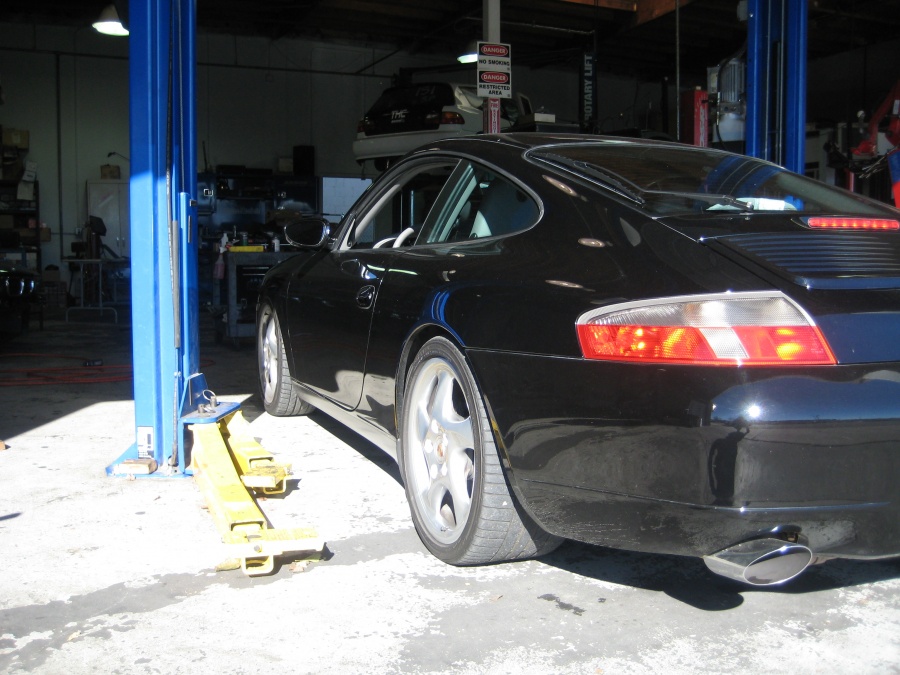

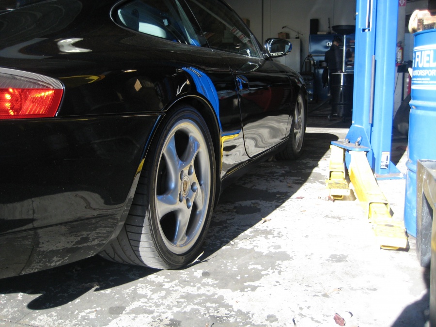

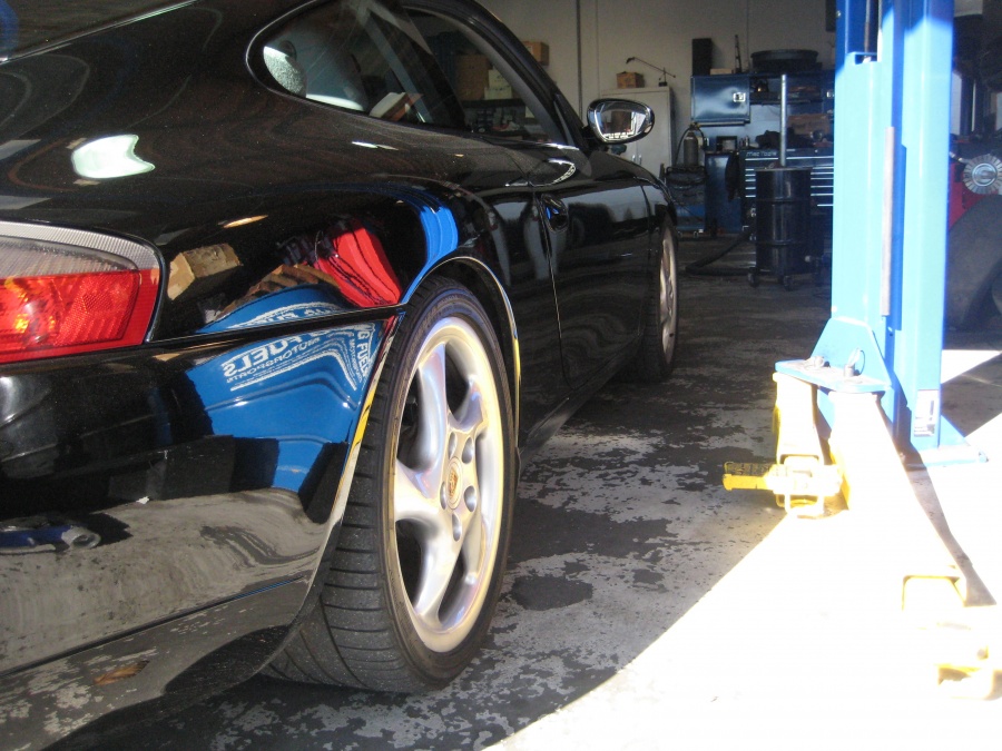

spacers installed
I took people's advice and installed spacers (H&R 15mm front; 7mm rear). Also got a 4-wheel alignment and adjusted the ride height to 24-7/8" on all four corners. Here are some before and after spacers pics. Thanks everyone for the helpful input.
