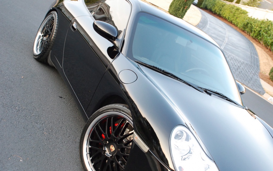

I had my 996 black calipers powder coated red, then had a PORSCHE decal applied, then clear'd over.
It was a simple job, for around $400. I did it because I liked how they "popped" through the black wheels I had at the time.
