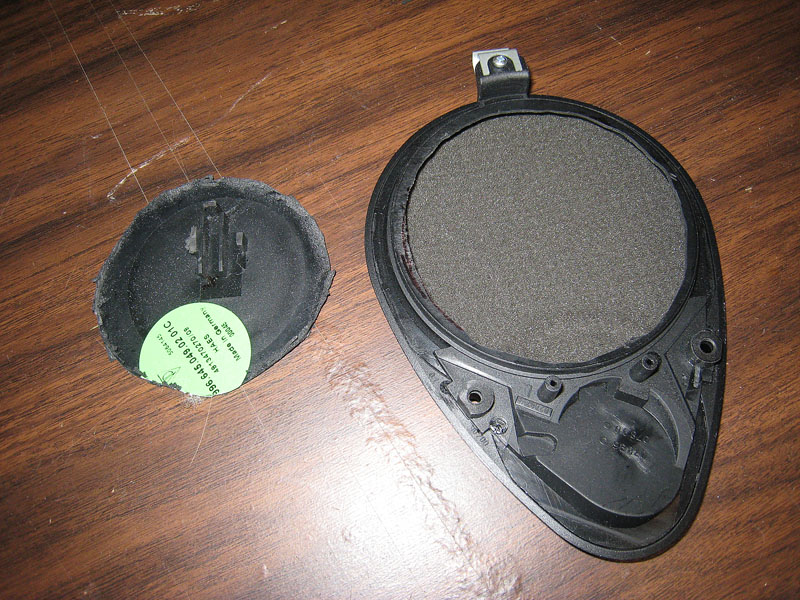

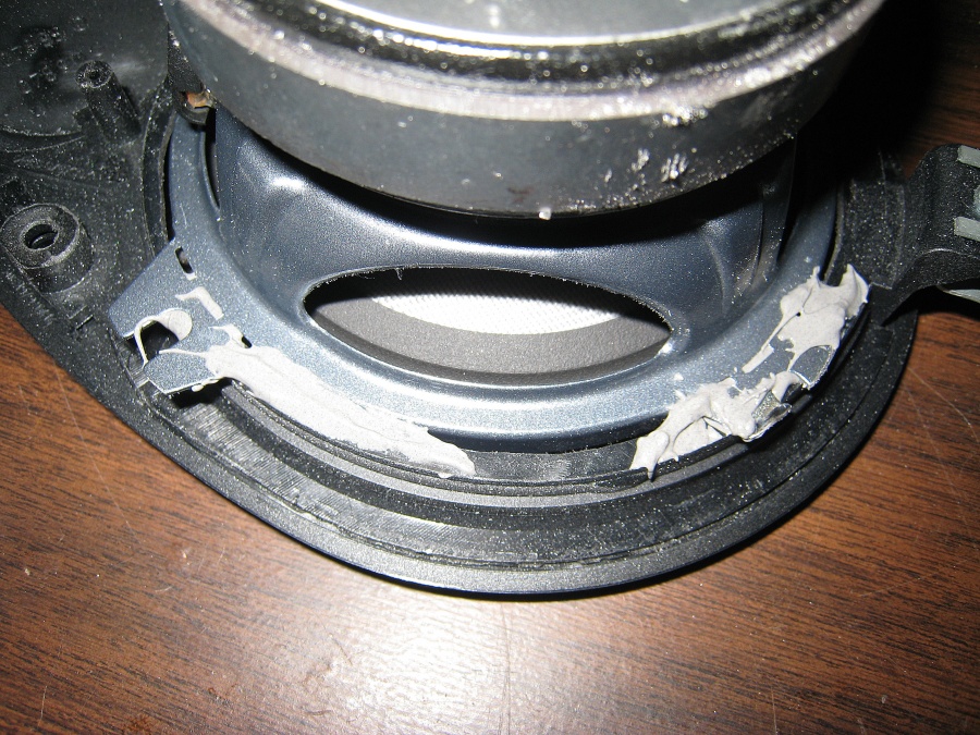

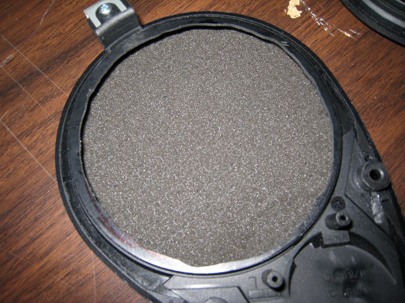

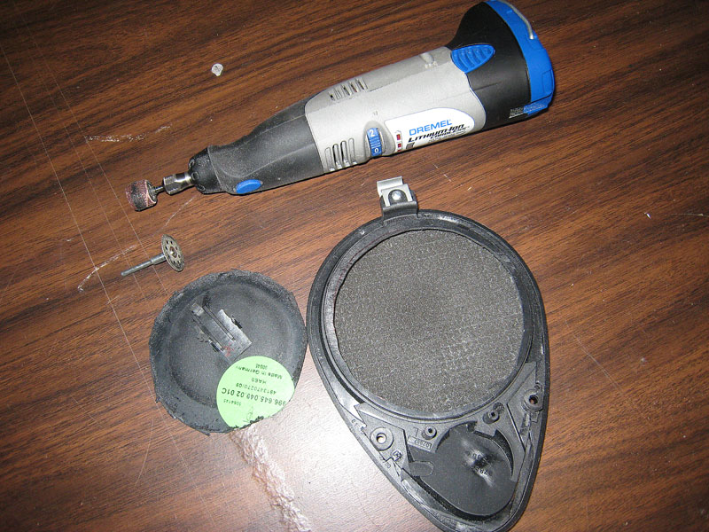

I'm in the process of upgrading the sound system of my newly purchased 2001 C2 cab without changing the head unit. I tried 2 different "mid-woofers" (all that really means is crappy bass) with no real improvement to speak of. Then I found these 5 1/4 subs by Tang Bang. The reviews on their site were very positive so I thought I'd give them a try. The model number is W5-1138SM 5-1/4". I bought them at http://www.parts-express.com/pe/show...number=264-831 for only $33.86 each!
Well it took some creative dremel handiwork as the magnet is longer than the OEM speaker so i had to make a hole in the back side of the plastic bucket large enough for the magnet to go through, but these subs are a HUGE improvment over stock! Even withn the loudness turned on, they don't break up until it's too loud to listen to. I'm thrilled with the bass response out of these.

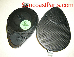

I have some Infinity Kappa's coming for the front and back. I tried Autobahn's - complete waste of money. I learned that Suncoast Porsche sells a speaker delete grill. It comes with no opening so you can easily customize it for aftermarket speaker installations. You can find them at http://e-partssales.com/Merchant2/me...9966450490201C

Sorry but I don't have pics of the surgery but it was fairly easy if you are a handy person. Have you had the door panel off yet? If not, PM me and I'll walk you throught it.
I had to dremel the inner ring on the most forward portion of where the speaker fits in because the speaker frame was a bit too large. Then, I had to dremel a hole in the back like where the magnet goes because the magnet is too long. Just measure the end of the magnet, eyeball it for center on the plastic speaker housing and dremel away. Make SURE that your window is UP when you do this because the window glass is behind the speaker enclosure and if you slip, we'll you know the rest of the story!
Take a moment and check the screws that hold the speaker enclosure to the door. Mine were both loose on both doors and it rattled during heavy bass. There is like 3 or 4 philips head srews. You will have to peel back some of the door foam to get to them.

I purchased a pair of "Speaker Delete" grills from http://e-partssales.com/Merchant2/me...9966450490201C These are the grilles that Porsche installs when the client does not order speakers. What makes them unique, is that with a little creative dremel work, you can cut a custom sized opening for the speaker of your choice! I opted for a coaxel speaker so I only had to cut one hole.

Just curious, but why didn't you just remove the bass enclosure from the door panel and use a hole saw on a drill? Then you could have sealed the area where the magnet pokes through to prevent any moisture issues. Alternatively, if the magnet is only slightly protruding through the enclosure, did you look at all at putting a spacer between the sub and the enclosure to raise it up? Let me know if I'm missing something, because I'm going to give these a shot, as my drivers door "sub" is blown anyway. Thanks!
It would have been much easier to make the protrusion hole in the enclosures with them removed. I guess I was just lazy that day! If you don't take them out though, make damn sure your window is up! If it's down all the way and you slip while making the hole, you'll hit glass!

I had to "Dremel" the actual opening for the subs to fit and Dremel a 2"- 21/2" hole in the back of the speaker housing to accommodate the sub woofers magnet. Remember to either remove the speaker box or keep the window rolled up before you begin cutting as the window is directly behind the speaker box. If you don't remove the speaker housing to make the hole, make sure you go around and tighten the screws that hold it to the door as most all of mine were loose and rattled like hell with the new subs installed.
