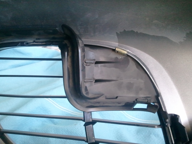

I'm just getting around doing the c4s front bumper conversion now on my 2002 c4. Bumper is all painted and ready to go but now realized that the headlight "eyes lids" from my original bumper don't seem to fit and can get the bumper hand as it seem that inner grill interfere with bumper support... any tips on what should I trim..?

The inside of the grills have a little tabs that you should take off. My bumper came with the black lining for under the headlights and was fitted with no problems...

Happy Thanksgiving....! Thank you for the quick reply. I will follow your advice, just to clarify: You mean trim this inner grill parts...? Did you just cut them off or attemp to remove them by undoing the plastic welds...?
Now that I learned how to add pictures I post some below to help the community if this is ever to arise again. Thanks so much again, I'll report back with the outcome.

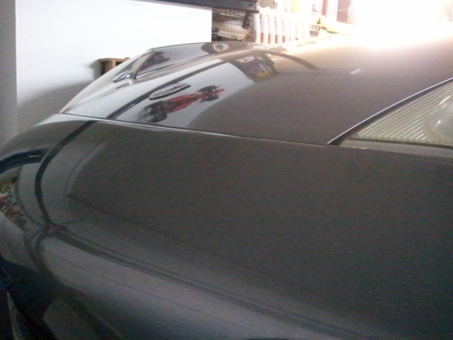

OK... finally hanged the bumper today with my wife help... after everything was in place I closed the hood and.... hood does not seems to match up with bumper like it used to. Should I have remove the inner foam...?

yes, those tabs need to be removed.... the bumper should fit a little above the hood... I can't see clearly on the picture what your problem is...

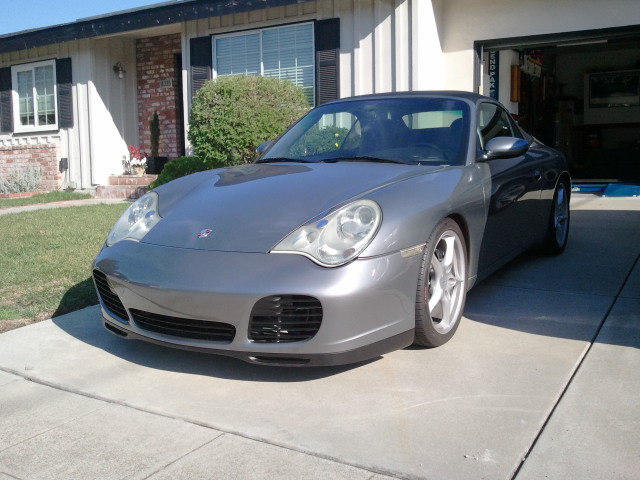

Thumbs up And the C4S bumper is done...
Just want to share with this community the final results of the C4S bumper conversion install on my C4. Special thanks to JoelPirela for his words of wisdom and encouragement as well as and all the wonderfull contributors of this thread.
As it turn out I was not placing the bumper inside of "the groove" that is under the hood hence the miss alignment with the hood while close (Dah totally my fault) but now all corrected. The only thin that I'm missing are the two trims under the headlights which I just found out are different between the C4 and C4S.
Anyone has two of these around that want to part with...?
