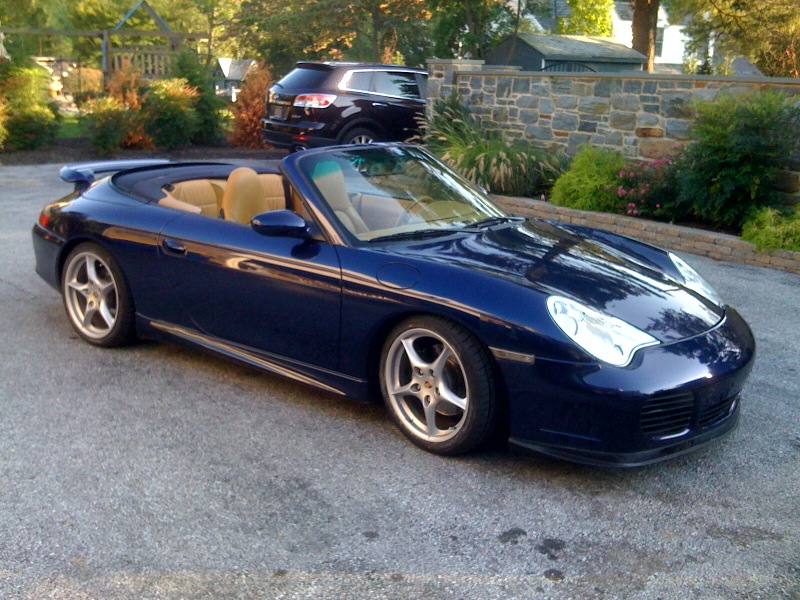

I have the Turbo bumper on mine as well. No issues with fitment.
On the MK2 only the rear is wider on the Turbo and C4S. I also have a modified Turbo rear bumper waiting for install.

Sorry forgot the Pic.

Are you referring to the front or rear bumper? The front bumper is a direct bolt on with no gaps or fitment problems. The rear bumper cover need to be modified and a custom L bracket installed behind the wheel well to make it fit properly.

It is an OEM bumper that was bought on ebay. It was advertised as a Turbo bumper but it may be a 40th anniversary. I was not aware that there was any difference between the 2 so I never checked. I do not have any pictures of the bottom part. I will take a look when I get home this evening to see if the body shop rigged up any straps. This is the first time I have heard of any issue installing a Turbo bumper on a MKII 996.
