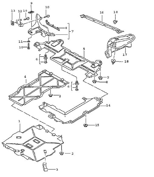

I had a panel fall off right before my trip and drove it to the airport w/o the cover on it. I'm sure it's not the end of the world but if anyone is intimately familiar with that part of the car can you tell me what those covers or shields are called? I'd like to order a replacement from Suncoast and have it next week. Hopefully a piece of plastic that is going to get the crap kicked out of it under the car isn't more than $200

They're not expensive, but there are a lot of them. You need the correct fasteners as well. If you have the old part, the part number is on it somewhere. Otherwise, look at the parts diagram or go to the dealer and ask the parts guy to figure it out.
Which piece is it?
-td

Numero 5
Numero 5
Part Number: 996-504-129-01. New from Pelican is $99.75.
Suncoast may be cheaper. 877-923-1700
(Don't forget to ask what connectors you need to put it on)
-td
