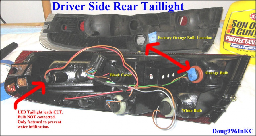

Exclamation Driver-Side Sits Lower Than Stock
Attached is a photo of the connections I made for the driver-side light. The fitment wasn't very good. The light sits lower than factory, which means there's a gap at the top. I'll work on the passenger side and if they both sit too low, I may return them to Edwin. If only the driver sits low, I may ask for a replacement driver-side. I've only tested parking lights, not blinkers.
Photos attached -- Red/Smoked.
UPDATE: SEE POST #61 BY "zdr2k". THERE SHOULD NOT BE A GAP BETWEEN THE TWO PEGS SHOWN IN THE THIRD PHOTO BELOW.

Thanks for the diagram, I hope you post the passenger side when you get it done. TIA..
Do you have Litronic lights? Fitment is not close to perfect but I love the look of the lights.
I'm gonna go buy a grommet today, some guide pegs for the black rubber guides that are too short, and look for an LED flasher.

I will take a pic of it. we connected the red/smoked and we have asked the porsche dealership if there were any differences in the mk1 and mk2s and they said no. Everything blinked normal with lights on/off/flash/hazards. Maybe I can check it out this week?
Doug, thanks for the photos. How does yours blink? hyperblink like everyone else? If you want to return, that is fine and please let me know but for those who want to return, please make sure to not make any modifications to the lights so we can either return them back to the manufacturer or sell them on ebay with disclaimers about the hyperblinking.
Doug,
I looked again and the set on our car looks to fit perfect. Can you post a pic closer that shows where it's off? Refund is not a problem if you are not 100% satisfied. Has anyone else out there have the same issue?
Thanks
Edwin

Cool Top Gap Zoomed
Originally Posted by PrecisionPorsch
Doug,
Thanks
Edwin
Edwin, here are two more photos. Will find out tonight how the passenger side fits. Comforting to know you're standing behind the products! Thanks! (Will report back on blinking patterns tomorrow -- Thursday, Apr. 23, 2009)
