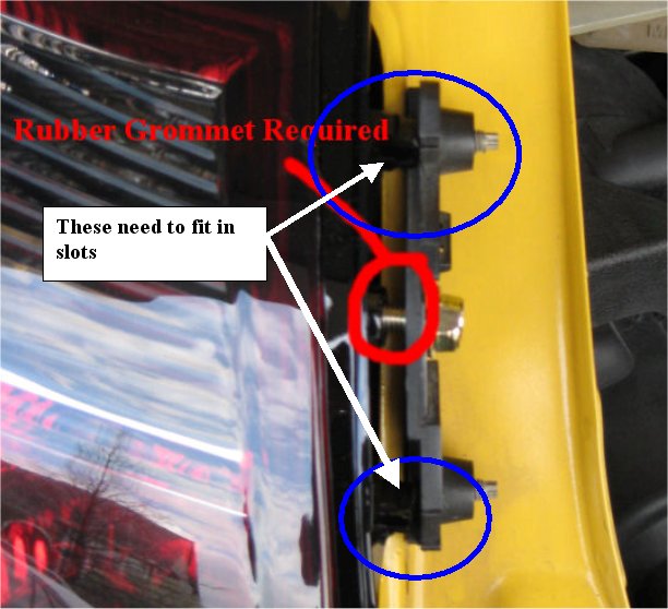

the grommet would go on the other end and the two pegs need to in their respective slots by the bolt.
see pics.
see pics.
I have a feeling I didn't install mine correctly, especially since there is space between the "two pegs". I bet if I move the light over against the "pegs", the gap issue will be resolved. Please let us know the grommet specs you decided to use, and how it fastens.
Thanks ZDR2K!
see pics.
were do i get the rubber grommet from??

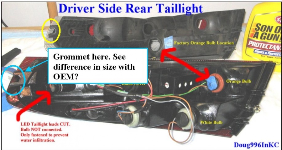

Install Followup
Installed the passenger side light and it fits much better. The bracket on the car that holds the two prongs can be adjusted up/down. I fiddled with that bracket on the driver's side and it looks pretty good now. The large gap is no longer an issue.
A rubber grommet is still needed on the opposite side though.

Doug,
I'm glad to hear you got everything worked out. The light to not plug in is not the reverse light but the wedge bulb/parking light.
It may seem that the mk1's don't have an issue b/c Doug (2000) and our 996 (1999) doesn't have the hyperblink issue
For those with the hyperblink issue, what year is your 996?
Edwin
