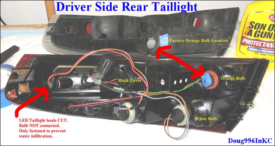

Originally Posted by Wheelman
Doug, did you take pics of which plugs to plug in each slot on the passenger side? I will re-install mine tonight. Maybe I plugged them in wrong.
Mine is an 02 with HID
Connections are the same as the driver. Here's the driver pic. Make sure the "black covered" (see pic) is in the correct "socket", 3 cutouts/divets to 3 on the piece containing the wire. (Difficult to describe this without pics, I know -- at work, will post photos tomorrow.) I had to remove the black electrical tape from a few of the wires because the connections made on the factory light are NOT THE SAME AS THE AFTERMARKET LED LIGHT -- per, for example, the "orange" factory bulb in the photo.
BTW, I used the "Son of a Gun" protectant to soften up the seals.
