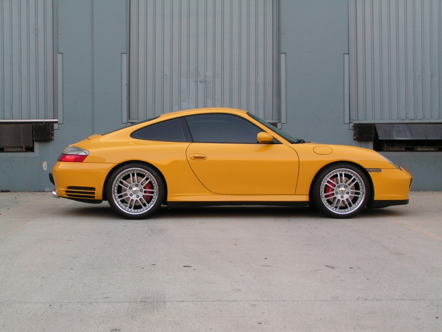

I'm new the the Porsche family and I'm really enjoying my car. I've recently purchased a 2002 C4S and I'd like to get an idea of tire wear on fronts compared to the rears. The car came with Pirelli P-Zeros on 19" wheels and the rears look to have about 25%+ more wear than the fronts. The car was lowered with a PSS9 kit and was corner weighted and aligned by GMG so I'm assuming all is right there. I would assume even with 4WD the rears wear faster than the fronts. Am I correct in my assumption? If this is correct would it be correct to say I'll go through 2 sets of rears for every set of fronts? I'd like to get a set of PS2's put on when the rears go, but if I can run another set of rear P-Zeros while the front run their course I'd probably do that instead since the fronts seem to be holding up well.
I'm sure driving tendencies play a major factor, so I'm basically using it as a weekend driver on as many twisty roads in SoCal as I can find.

congrats on your speed yellow c4s purchased!!!, i just bought mine 2 months ago, love the every curve of the wide body c4s, maybe some day we can have a meet and take photos, i am living in S Cal too

Are those Momo wheels? If so, I believe you bought my old car! I sold it Dec '08 and saw it in the OC Craigslist two months ago. Yes, no? I put on the wheels and the PSS9s. I let the car go for a good price as I was desparate to buy a Ferrari and when I saw it in Craigslist, it was at a higher price than what i sold it for!!!

Boxzing,
This must be your old car. I recognize Chino Hills from the docs. To keep my sanity I'd rather not know what you sold it for but I bought it for much less than what you listed it on here for. Hopefully I did alright. I love the car and it's running great. I hope to someday be in a position to act on being "desparate" to get a Ferrari! ;-) That's a beautiful car!

Was the last 5 of the vin 23549, Then I sold it to Chino Hills.
