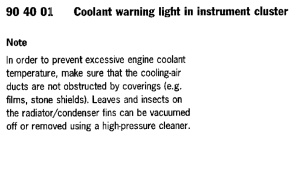

To me, this indicates improper air flow over the radiators. Air is restricted from passing over the radiators and down the ports. Also, the fans might not be working.
Let us know when you clean your rads. You might be surprised what you find in there!
As for the AC suggestion - there is a separate condenser that sits right on top of the radiator on the passenger side. If you have restricted airflow there, running the AC isn't going to help. I live in Texas, and have been on the track in 110 degree ambient temps. With the third radiator, I never overheated.
Here is what Porsche's take radiator cleaning:
