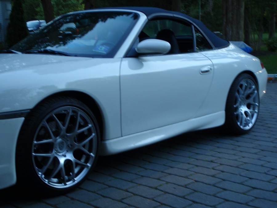

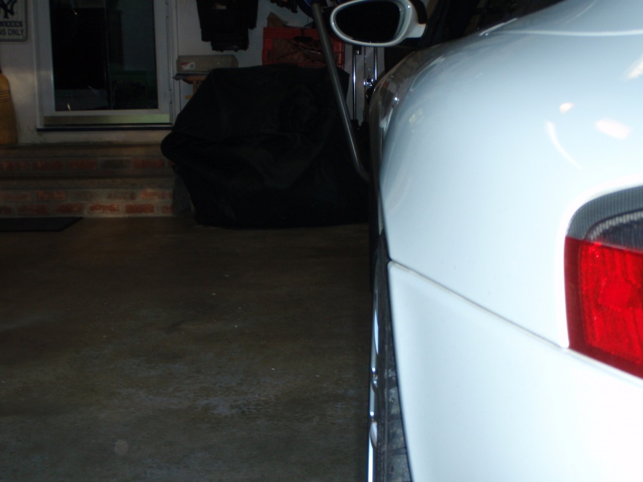

could you send a some pics from the rear that show how close they are to the rear fenders....
Old Jul 25, 2010 | 04:54 PM
nijoma's Avatar
Joined: Jul 2009
Posts: 503
Rep Power: 48
nijoma has much to be proud ofnijoma has much to be proud ofnijoma has much to be proud ofnijoma has much to be proud ofnijoma has much to be proud ofnijoma has much to be proud ofnijoma has much to be proud ofnijoma has much to be proud ofnijoma has much to be proud of
Pics
This is all I have at the moment
