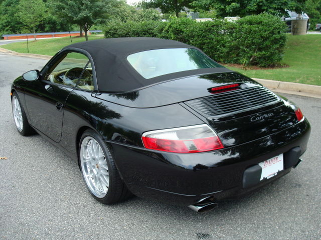

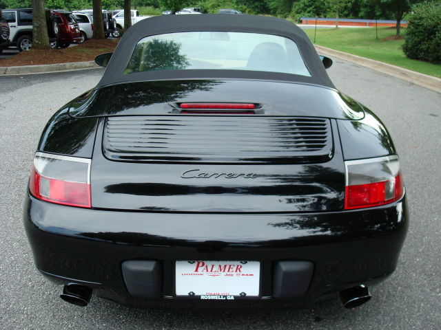

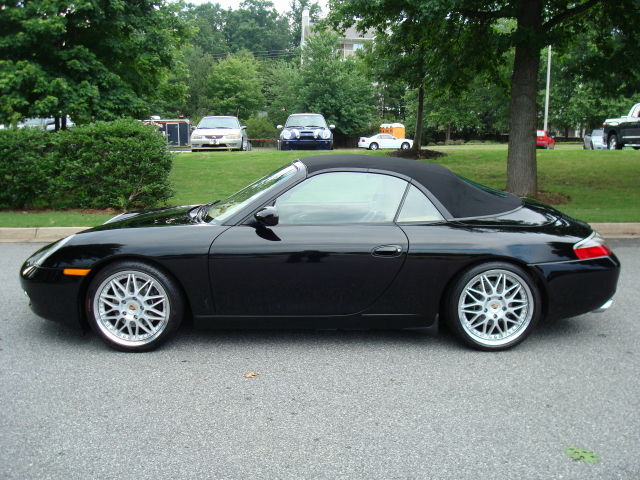

Here are some pics of the wheels and the back showing the exhuast tips. Not sure if these pics are helpful. How can I find out what kind of suspension and/or exhaust I have?

You're not gonna tell what aftermarket exhaust you've got just by looking at the tips. You need to look at the mufflers themselves and see what stampings, part numbers, or other identification is on them.
From the side profile of your ride height, you've definitely got an aftermarket suspension system. Whether it's springs only, spring and shocks, or coilovers we cannot tell by the pics. Again, you're gonna have to look at the suspension to determine this. Make note if you're using the stock perches, and if the shock bodies are black or differently colored, or if you notice any identification or part numbers. Take some pics of the suspension bits and we can help you out.
