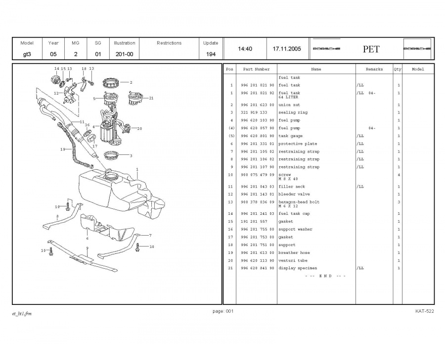

where is the fuel pump???
Old Jul 5, 2010 | 04:34 PM
Omarcoolguy's Avatar
Posts: 941
From: Chicago
Rep Power: 71
Omarcoolguy has a brilliant futureOmarcoolguy has a brilliant futureOmarcoolguy has a brilliant futureOmarcoolguy has a brilliant futureOmarcoolguy has a brilliant futureOmarcoolguy has a brilliant futureOmarcoolguy has a brilliant futureOmarcoolguy has a brilliant futureOmarcoolguy has a brilliant futureOmarcoolguy has a brilliant futureOmarcoolguy has a brilliant future
any pics....or any help, cant google any images.. anyone replace a fuel pump on a 996???
do i have to drop the tank?...i need a DIY .
thanks
Old Jul 5, 2010 | 04:36 PM
GT3 Chuck's Avatar
Administrator
Posts: 15,099
Rep Power: 1002
fuel pump is in the tank...although this is for a GT3..you get the idea

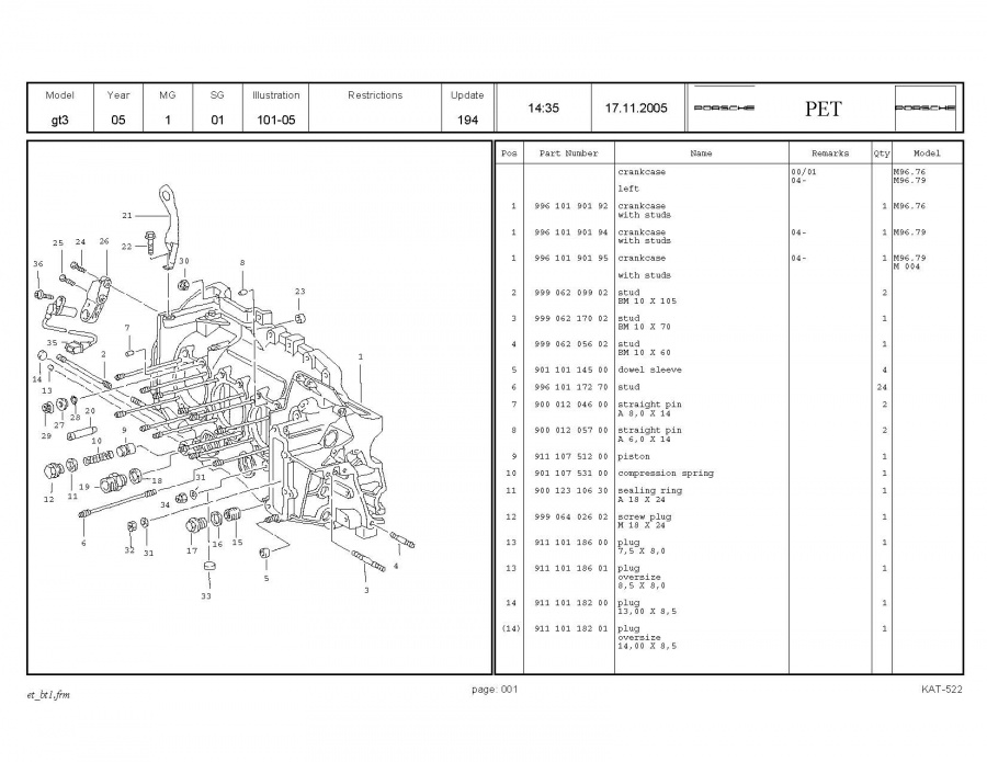

The crankshaft pulse generator position reads the gap (two missing teeth) in the flywheel ring gear. The gap produced by 2 missing teeth serves as the reference mark and lies 84° before the TDC of the 1st and 4th cylinder. This is what it reportedly looks like...
this is where it mounts on the 996 GT3 motor..item 35
