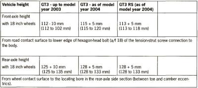

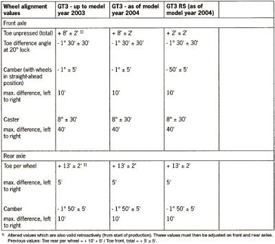

I have a C2 so not sure about AWD. My car is a DD plus I do about 15 track days a year. I ended up with the "GT3 alignment spec" plus some extra camber (-1.5F and -1.8R). I've had this setting for a while and feel this to be perfect for what I need.
Updated GT3 (mk1)/GT3 (mk2)/GT3 RS specs:
Height:
911 GT3 M002 = road version and 911 GT3 M003 = Club Sport version are the same as far as adjustment is concerned.
The GT3 - from model year 2004, is also offered in USA. The values listed are valid for RoW and USA.
The GT3 RS (as of model year 2004) is not offered in the USA (August 2003 version).
Alignment:
[IMG]file:///C:/DOCUME%7E1/Jason/LOCALS%7E1/Temp/moz-screenshot-3.png[/IMG]
