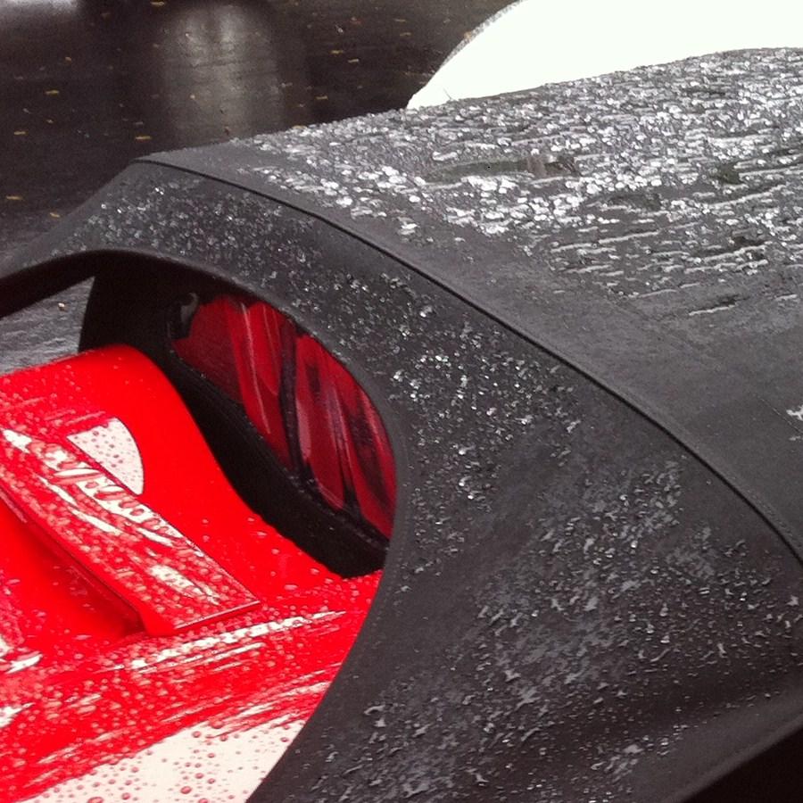

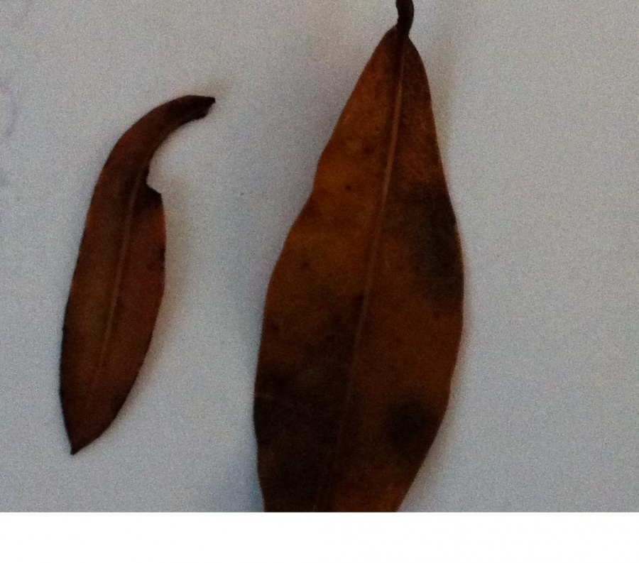

Here are two images. One is my spyder sitting in a two day rain at work. Dry inside. ( it is garaged at night. ( the 996 is outside). The other image is just a sample of the oak leaves that had already COVERED the posterior drains in the Spyder. Ther drains are large at the top to capture any water, but these Oak leaves are everywhere.
those suckers were everywhere... I mean everywhere
