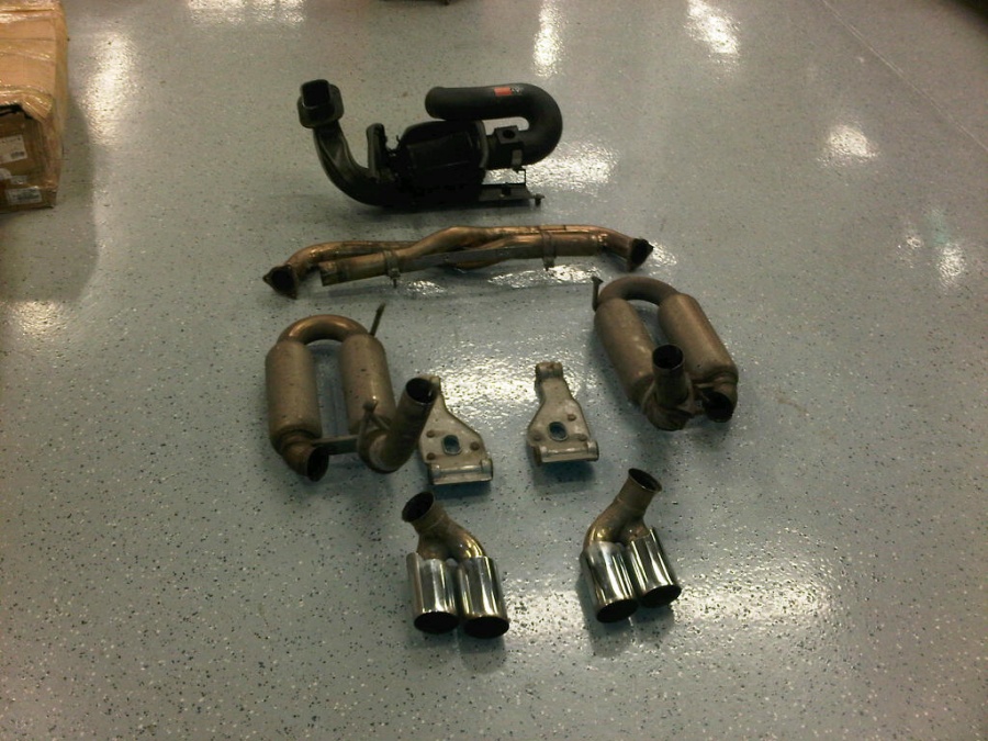

I've had both Cargraphic and Eisenmann mufflers on past 996s. On my current car I had a local shop do the Fister style exhaust mod, I can honestly say that I'm just as happy with the sound. It is actually very similar to the Eisenmann. The only benefit that you don't get with the Fister mod is weight loss, most aftermarket mufflers are significantly lighter than the OEM cans.

If you want to pass CA smog, go with Fister D partial muffler bypass or Fabspeed muffler bypass. Cat bypass or even 200 cell sport cats will trigger CEL and fail smog.
Even for pure sound, be careful as a high flow set-up will be *** loud! I ran K&N CAI, 200 cell cats, and regular Fister D for a week as a daily driver and it got old really fast. Had to have Darin customize a more restrictive muffler bypass to find the ideal sound.
