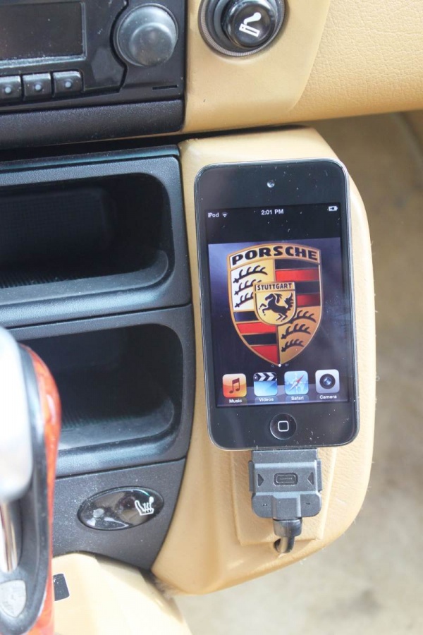

I have the Becker cable for 4G iPod Touch/iPhone and I'm very happy with it. It's more expensive ($100 iirc) than the ones for earlier iPods. It uses the normal iPod connector, like the one you use to connect it to your computer, not RCA plugs.

Maybe it is, but I was talking about a cable for all iPods and iPhones, including the latest 4G devices. This is a single connection that plays through the radio and keeps the iPod charged. Here is my set up.
