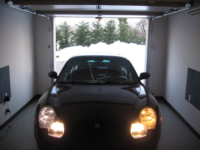

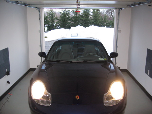

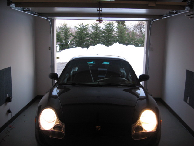

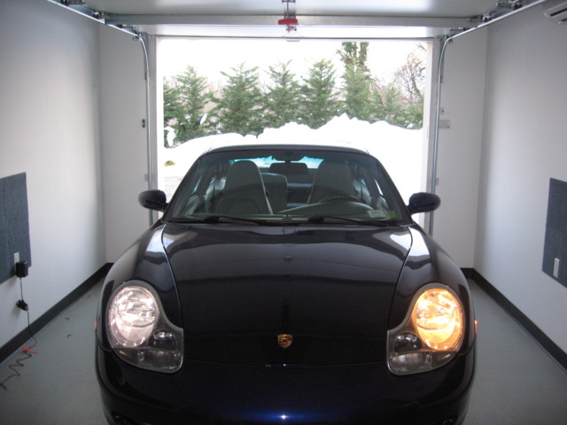

I replaced my stock parking lamps, fog, low beam and high beam halogens with PIAA bulbs. Fog, high beam and low beam are H7s (despite the fact that the Sylvania automotive bulb giude says they're H3). I replaced those with PIAA Intense White (4150 Kelvin color temperature) and the parking bulbs with PIAA 168 wedge parking bulbs, which are available in Xtreme White Plus (color temp 4000 Kelvin). I got all the bulbs from Auto Barn locally, but they also sell online at www.autobarn.com. Below are pictures of stock (on right) vs. PIAA bulbs (on left) of (1) parking lamps only, (2) parking and fog lamps, (3) parking and low beams, and (4) parking and high beams.
Replacing the yellowish parking bulbs is probably the most worthwhile mod you can do -- for a mere $14.

Oggie - The difference in the parking lights is very noticeable in your photos, while the other differences are very subtle - almost indistinguishable. Are the differences more pronounced when you see the car in person?
Yes, the difference for the other lamps is quite noticeable. The photos just don't do them justice.
