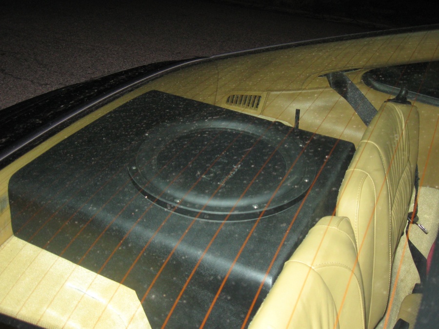

Nice sub-box, did you make it? I'm having trouble fitting a JL 8w7 sub behind my rear seats as its magnet and depth is too big to fit. I made a box to get it to fit but is an eye sore when I look back there, so i'm back to the drawing board to make it fit. Thinkin of doin my first fiberglass project but kinda hesitant to mess with that stuff.

Yes- I built that box. Speaker depth is the big issue which is why I put a Polk MM1240 in there. It is not a true shallow-mount woofer but is very shallow nonetheless. And 12". Boom.
