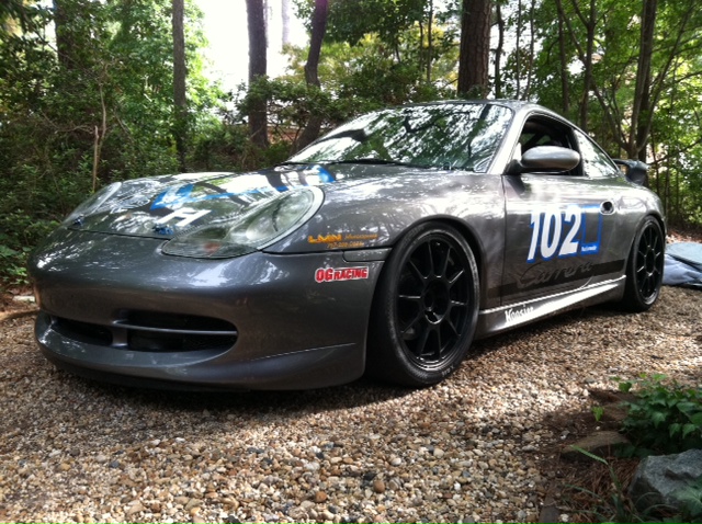

Tire Sizes
Here is a picture of my 2002 Carrera with the ROW030 lowered suspension and GT3 Wheels powder coated black. Plenty of room for lowering still and no need for rolling front or rear fenders. Note to what is rolling fenders? There is a tool you can bolt to the wheel and roll the inside lip of your fender so it does not cut your tire. You will notice the GT3 comes with the front fender already rolled.
GT3 Wheels are Fronts 8.5X18 ET40 Rears 11X18 ET63 and tire sizes I run are 245/40/18 and 295/30/18
Also, my Stock H track car is very low. I did roll the fronts but not the rear fenders. Needless to say the negative camber is much more severe on that car. CCW wheels using the exact same size and offset of the GT3 wheels

Old Feb 22, 2012 | 09:29 AM
  #28
scantu's Avatar
Joined: Mar 2011
Posts: 276
From: Astin, TX
scantu is infamous around these parts
This looks amazing!
