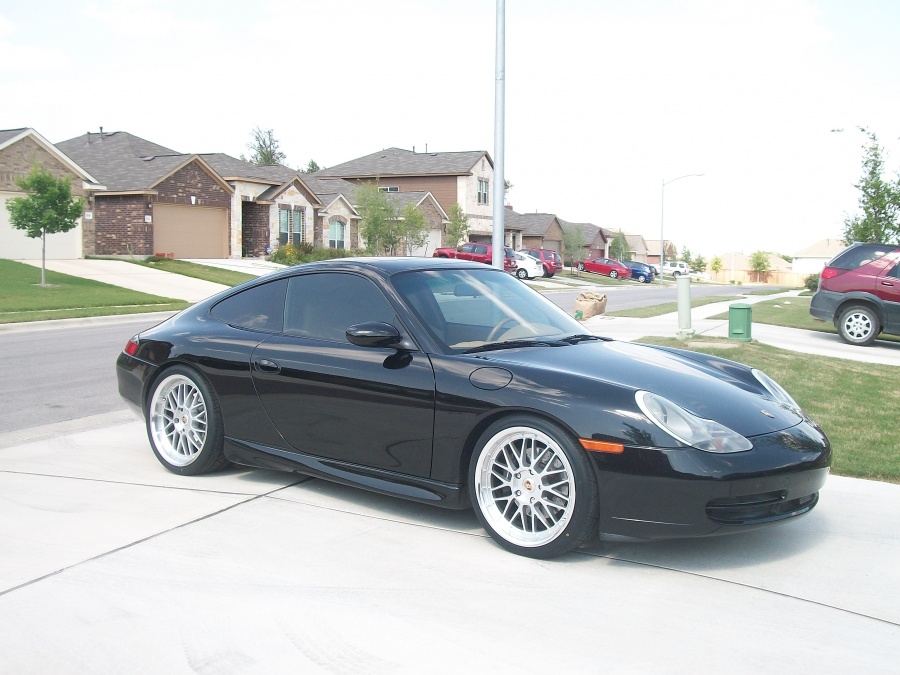

You can get 11" to tuck, but you will have to roll the fenders:
Here is my C2 with 11' wide 51 offset:

you shouldnt have to roll the fenders with the correct offset on an 11 with 18s. The 19s will require some modification, I just purchased 18x11 innsbruck (will be here tomorrow) with a 55 offset which is less aggressive than the 51 strat is running, I dont expect to have any rubbing issues with the coilovers ill be running. Will update on how it fits when complete

Im running 11s with 315/25/19s and I have H&R springs. Absolutely NO cutting needed with the correct offset. I barely needed to roll the lip.

Im running a 19x11 with a 63offset. I only had to roll the very back side o my fender..... easy fix.
As Strat10 shows issues with rubbing and having the need to cut the fender is because the offset is too low. The lower the number the farther out the wheel will sit. Move that same wheel to a 63 and it will tuck nicely.
