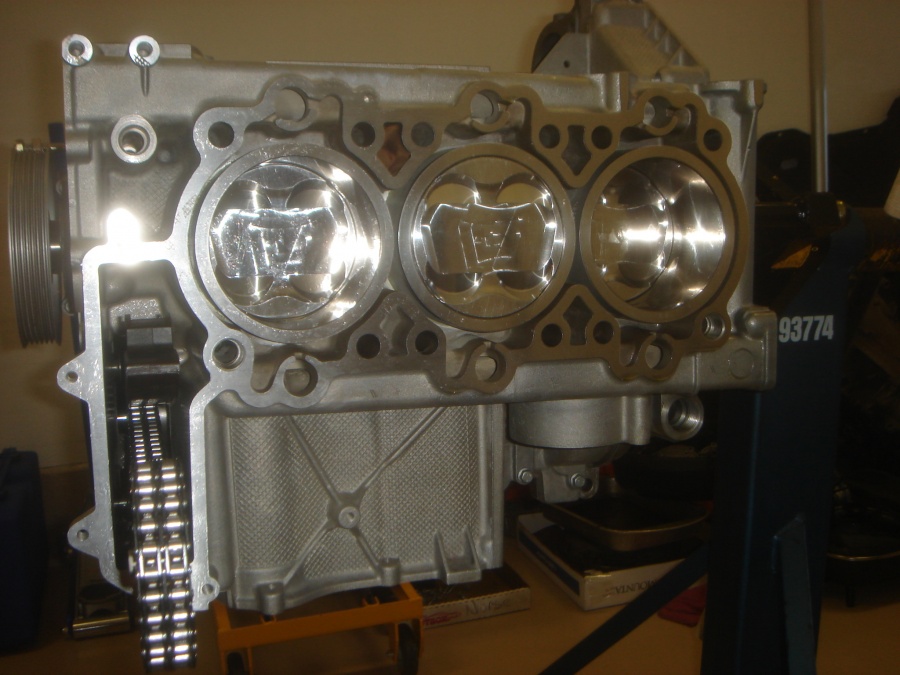

The best way to do this is to rebuild your original engine with LNengineering.com Nickies sleeves & JE pistons that will not only yield the 3.8 displacement increase but will provide a much stronger crankcase & cylinders, pistons, & IMS bearing. Since it is the correct year engine for your car it requires zero alterations to any other component.
I can do this in my shop for about $13,000. It takes about 2 months to have the sleeves installed @ LNengineering

I had to get a custom 3.6 to 3.8 tune, which was done by fvd. No wiring had to be replaced.

That about boring the 3.6 to 3.8, is probably the best way to go. And way cheaper.

Rook = very bad reviews. You can convert the the 3.6 to a 3.8, reliably, by Flat 6 innovations. Bulletproof.

Ditto on recommending the F6I 3.8L upgrade route...
