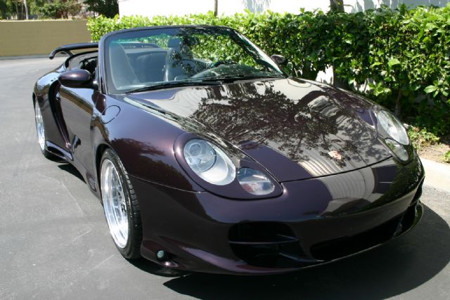

Here is a photo of a 99 C4 996 conversion. This was done by ANZIANOS in Santa Ana.

Heres the photo

Sweet pics but those aren't factory quarters. That's a widebody conversion but I was really hunting for the factory intake look. Actually, I've seen the car Neil is refering to on Ebay and the only other one I know of I saw done by Gemballa in a magazine article I have saved.
