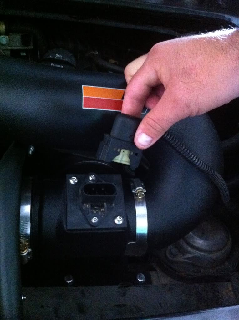

Pop the trunk lever and lift the trunk up to view the engine. Next will be the removal of your MAF sensor connector, squeeze the clips and it disconnects right away. Be very careful as damaging this connector will cause lots of problems later on. Yours may be located a little further right on your stock intake setup, behind and on top of the stock airbox.

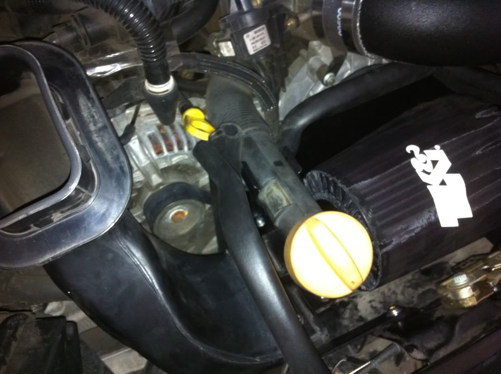

Now for the removal of the airbox, I have an aftermarket K&N as you can see, however the stock airbox is even easier to remove. One 14mm bolt to the right of your trunk release mechanism hold the entire airbox in. Remove this bolt, disconnect your clamps holding the airbox to the throttle body and the whole assembly comes right out.
Here is a shot with the airbox/intake removed.

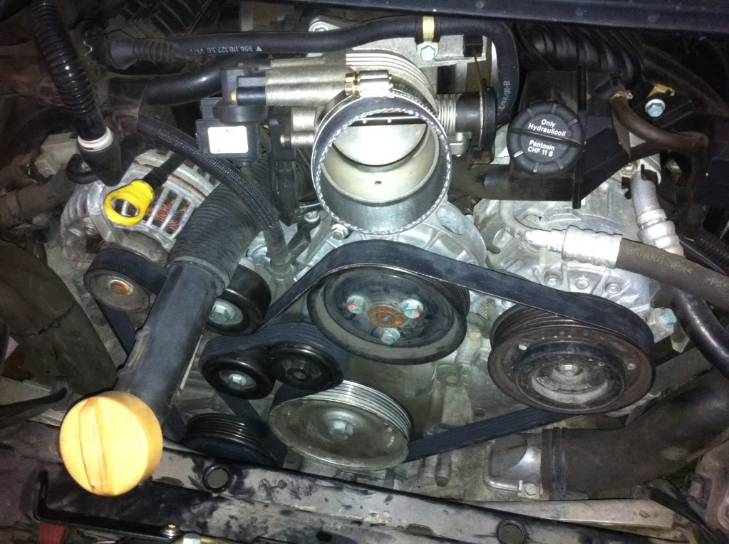

It is a good idea to have a diagram of how the belt runs, or take a photo like I did, so that you know the correct path the belt should take when you replace it. Always think ahead!

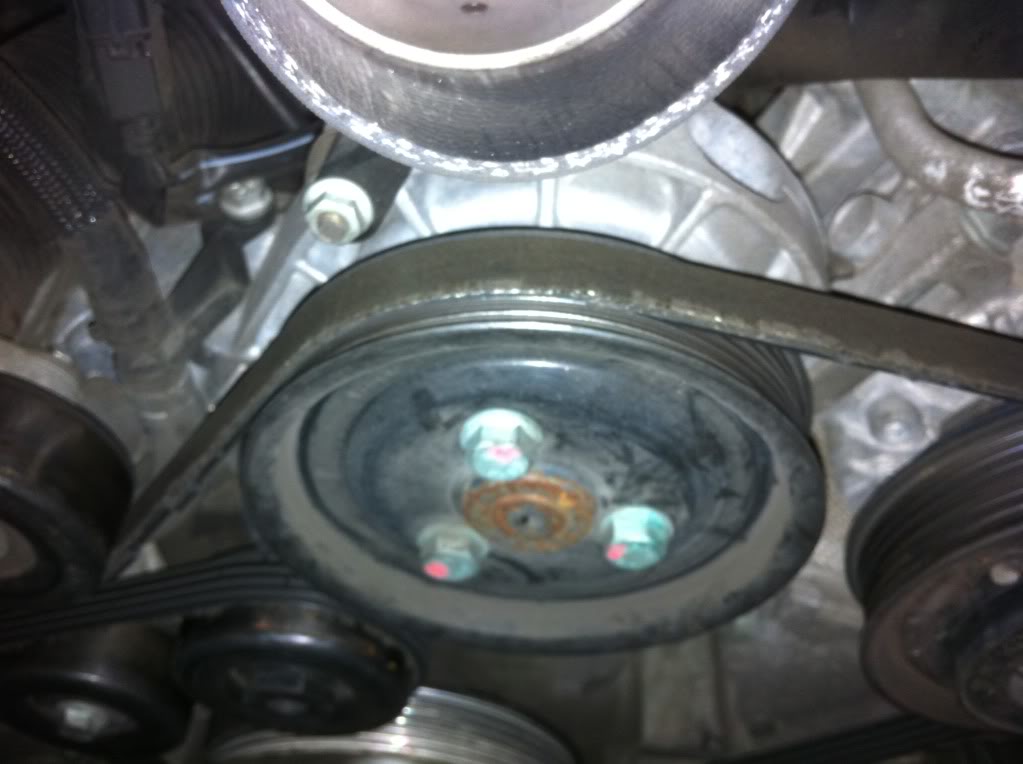

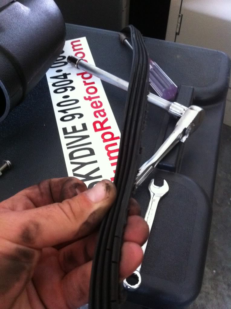

You can see in this photo, just how bad my belt was, and the obvious reason for it's replacement.

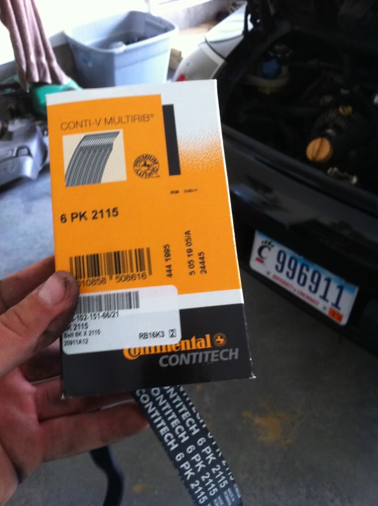

Now, here is the new belt, as well as it's packaging material, so you could all see the part number. This is a belt from one of Porsche's OEM suppliers, so I felt confident in it's ability to perform as well as the original.

Place the new belt over as many pulleys as possible, using your photo as your guide to ensure you have the correct belt path. I chose to leave it off the center top pulley (the focus of my bad belt picture is on this pulley) as it seemed to be the easiest option for routing and because it is accessible while your other hand is busy with the tensioner/wrench. Again place the wrench on the tensioner and turn clockwise. Slip the belt up and over the pulley ensuring that the ribs match the grooves. You may have to use a flat head screwdriver to leverage the belt up and over the top of the pulley as the belt is a very tight fit. It would be easier at this stage to have a second pair of hands to untension the tensioner while you slip the belt over, but that can be overcome. Only reason this even received 2 out of 5 stars.
Should look like this when you are complete.
