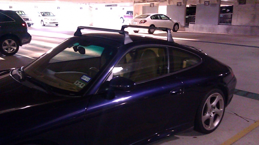

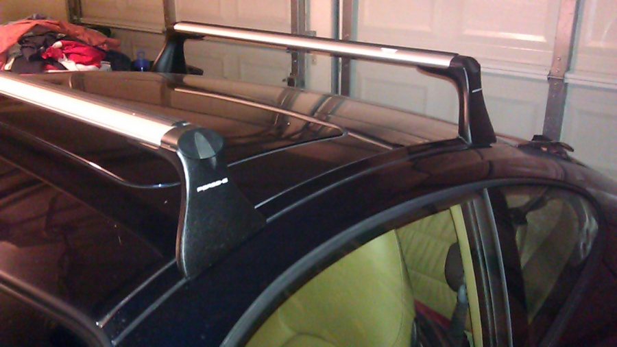

Not sure what happened to this set of adapters but I sent them back to the seller and they had the adapters plugged and tapped to the correct size. No problems with the rack now! Picx below.
Size:  137.3 KB Name:  Rack2.jpg
