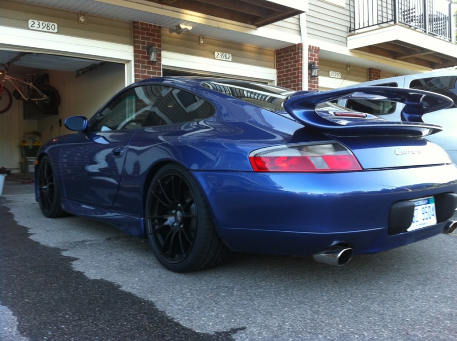

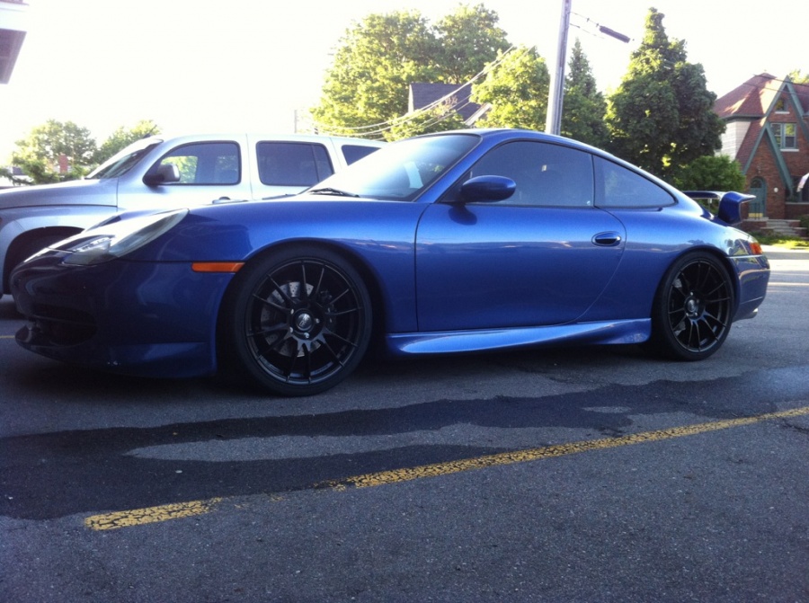

19's on 99 NB
I have 19x8.5 and 19x 10 on my car no problem at all. H&R springs too.... Fairly low. I don't have the offsets on hand but a quick glance at Tirerack.com should give you all the info you need.

It has definitely degraded the handling characteristics as compared to the 18's I had on it before.... but since this is a weekend cuising car for me..... the degradation was worth it to have the look I wanted.
