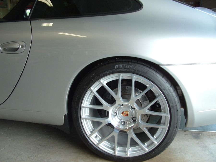

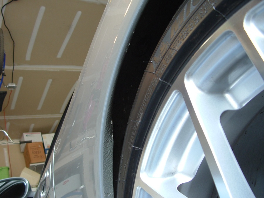

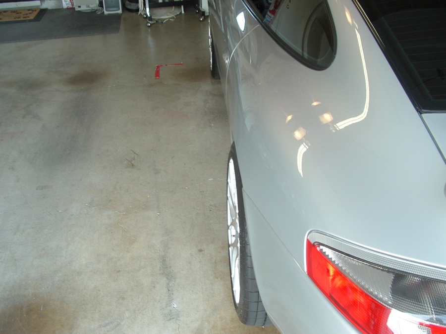

Ask and ye shall receive!

Wow sir you did a great job look very nice , ok rabbit you convinced me ,Iam having mine rolled
