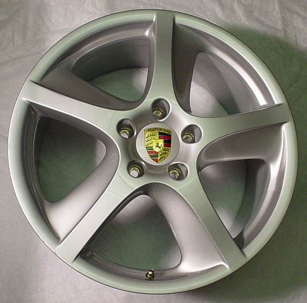

Since I'm probably the only one left on this forum with 17" wheels, I'm planning to upgrade to 18" wheels by buying a set of OEM Sport Techno wheels. Front 8x18, 50mm offset (with 225/40x18 tires) and rear 11x18, 63mm offset (with 295/30x18 tires), which the fitment that Porsche specifies for narrow-body 996's. I've heard that on 1999-2001 models, the rear fenders have to be rolled to avoid rubbing on the fender lip. But, I've also heard there's no issue. Can someone with these wheels/tires on a 1999-2001 please comment? Thanks.
Photo of Sport Techno wheel attached.
