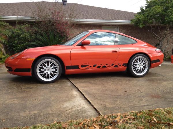

Thanks for the input. I would rather a 2002 if one were available, but these seem few and far between in Louisiana. This 2001 does have upgraded wheels and an updated headlight kit. Here is a pic:
Any opinions are much appreciated.
The Carrera writing is just a sticker. I will probably remove it if I buy the car. I just love the clean lines of the car without it.

I love the wheels .. what kind are they? So the upgraded headlamps.. are they the litronics?

The wheels are 19s. I don't know what kind of car they came from, but they are Porsche wheels.
The headlight kit is a piece of color-matched material that separates all of the individual lights within the headlight assembly. I don't know much else about that.
He also has a K&N cold-air induction kit and a muffler bypass (neither installed), and he has a B&M short shifter installed as well.

Looks like a good opportunity. Two things: do not install the K&N Cold Air Induction Kit or the muffler bypass pipes. Sell them on this site and keep what you have. Good luck!
