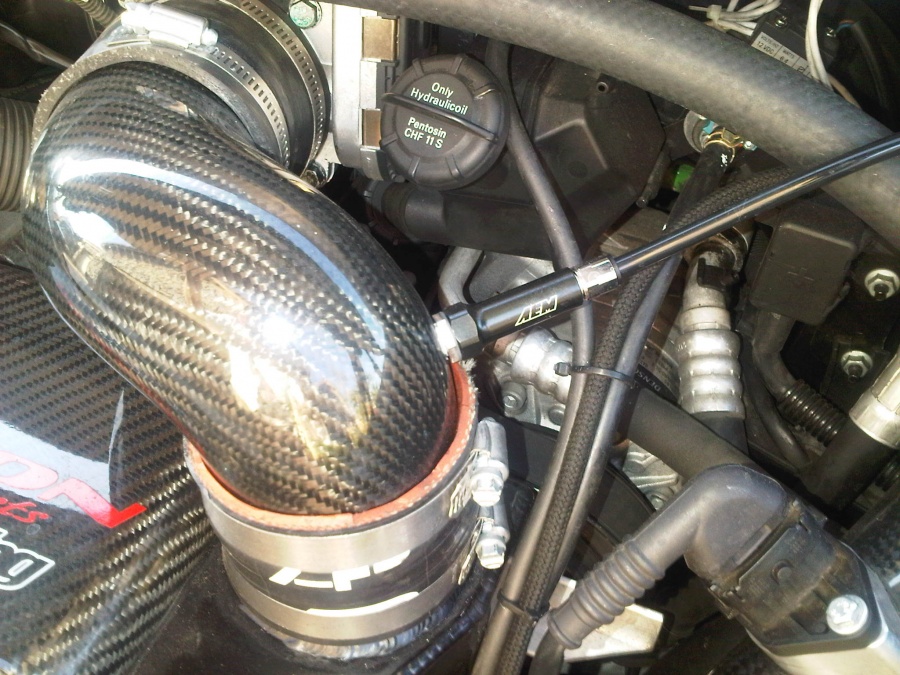

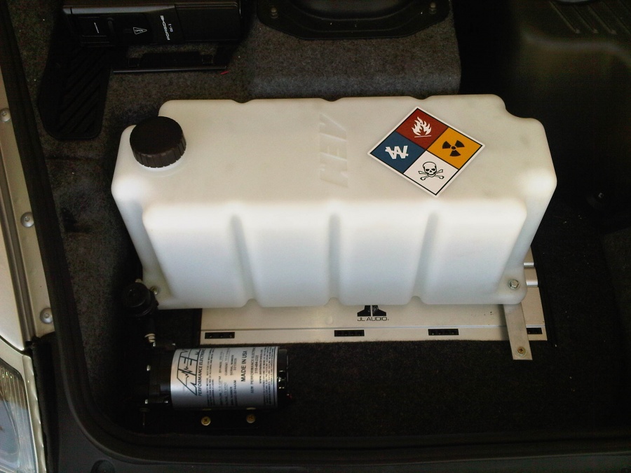

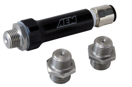

AEM Water/Methanol Injection Kit being installed now. It doesn't do to much for horsepower, Only a 20-30hp gain but it drops intake temps 50-150 degrees and also provides anti-detonation which a Turbo 3.4L needs because I'm running stock compression with 6 lbs of boost.

3) Vivid Racing VR996CT Turbo Kit (Precision 62mm Turbo, 60lbs Injectors, Turbosmart 40mm Wastegate, Turbosmart eBoost Controller)
4) AEM Water/Methanol Injection (50/50% Water & Methanol)/ Using 630cc Injector Nozzle.

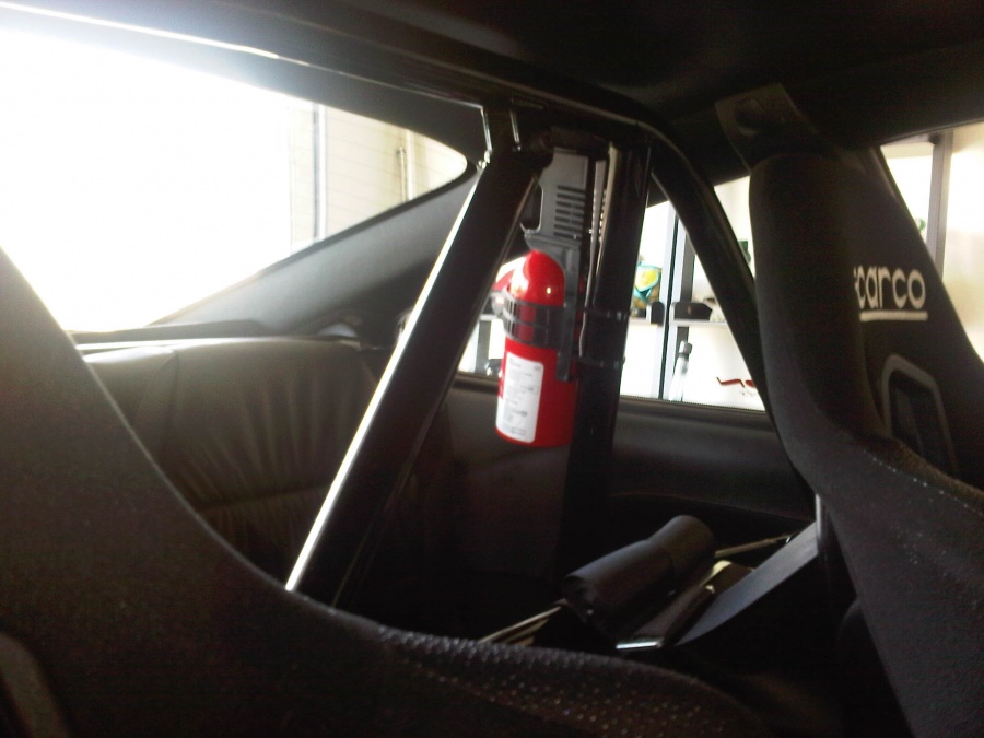

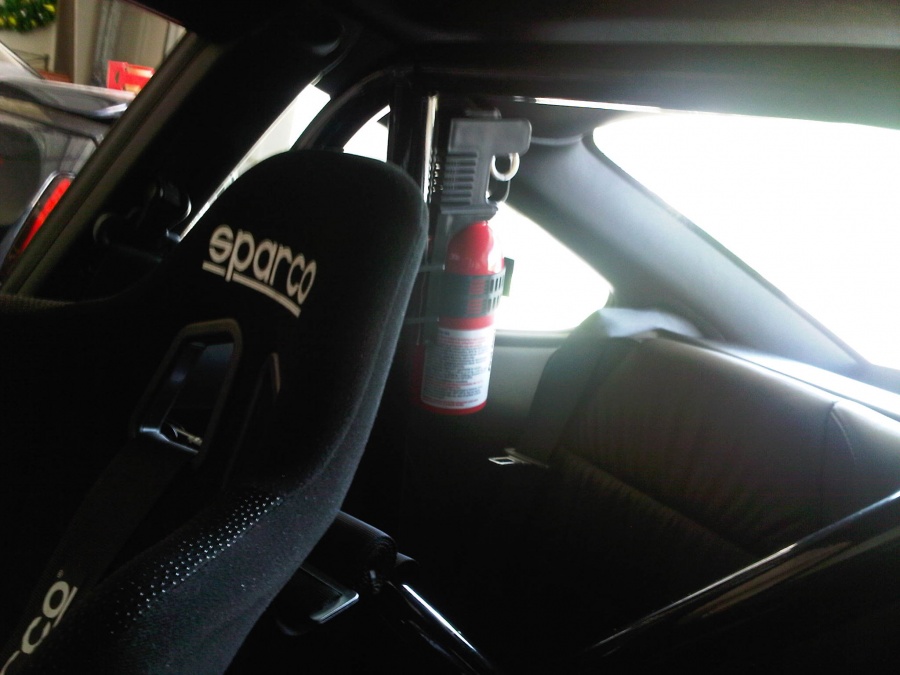

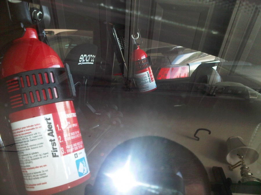

Car is going to be featured in the September/October issue of 9Magazine (www.9magazine.com). Finishing up some last minute touches, added fire extinguishers and rolled up and zip tied the excess straps from the Sparco Harnesses.
