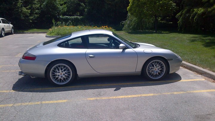

Team at Vivid Racing will be fixing some internal issues with my engine, then I will be ready to hit the road again. Had been hoping to do a body kit by now but will have to wait till way next year. When Vivid Racing finishes up my engine, I'm looking to enjoy some long scenic drives in Arizona.

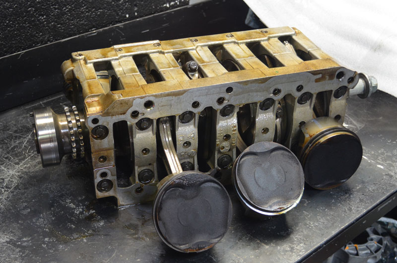

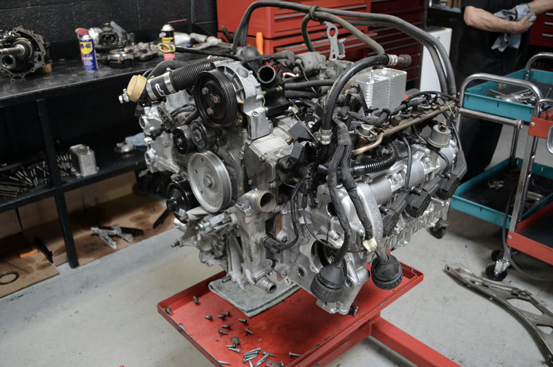

The Team at Vivid Racing has been great (Dan, Rob, Heath). My engine had over 100,000 miles and I am running a 62mm Turbo and 5.5psi of boost. Just time to be reworked, they tore down my engine and doing a rebuild, my pistons and rods where in great shape, they found a hair line crack in my head which is being addressed and then doing new piston rings, seals, gaskets, AOS, water pump...ect. Then re-tuning my car. With the VR996CT Kit and rebuild engine I should easily dyno 375hp to the wheels on low boost.

Engine fully rebuilt and back together, will be installed, tuned and dyno'ed in a few days. Along with the Engine and Heads being fully rebuilt I did:
1) APR Engine and Head Stud Kit
2) New Cylinder Head
3) LN Engineering 160 Degree Thermostat
4) GT3 3rd Radiator Kit
5) AASCO Light Weight Flywheel
6) Repainted Car (Factory Arctic Silver)

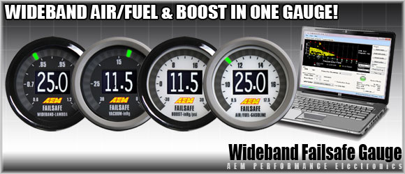

Just added a center Pod to the steering wheel trim with AEM Digital Oil Pressure Gauge and AEM Air/Fuel/Boost Failsafe Gauge.
The AEM Failsafe ties into my Turbosmart eBoost and im adding a laptop under my seat with my Durametrics and AEM Safesafe USB Options running from the hidden laptop to my Kenwood Head Unit on AUX Video.
Interesting... How come you're duplicating the oil pressure gauge? Is the factory one not good enough?
I'm going to be doing a lot of data logging and record keeping, so I need exact oil pressure readings along with boost and air/fuel readings.
