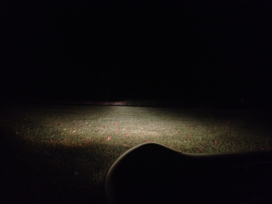

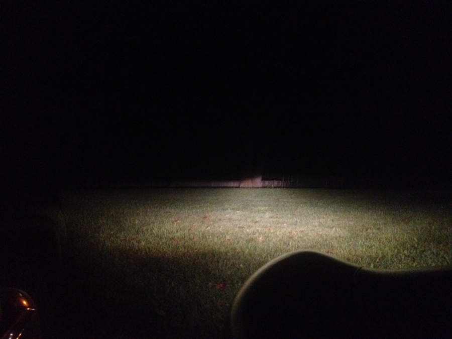

Installed them yesterday after work, these are some of the easiest headlights ive worked on! Very easy to remove and swap bulbs and reinstall. I drove home and around for a little while and they dont seem to be putting out any additional heat over the stock bulbs as these are simply an H9 filament in an h7 housing. (our highbeams are also H9's so the headlights are made to handle it, and if they fail regardless, perhaps I will be replacing the housings in 10 years instead of 15). The light is brighter and sharpens the peripheral view. Its not night and day difference in the pictures but its definitely noticable IRL and when driving.
New Bulbs
Old Bulbs:
