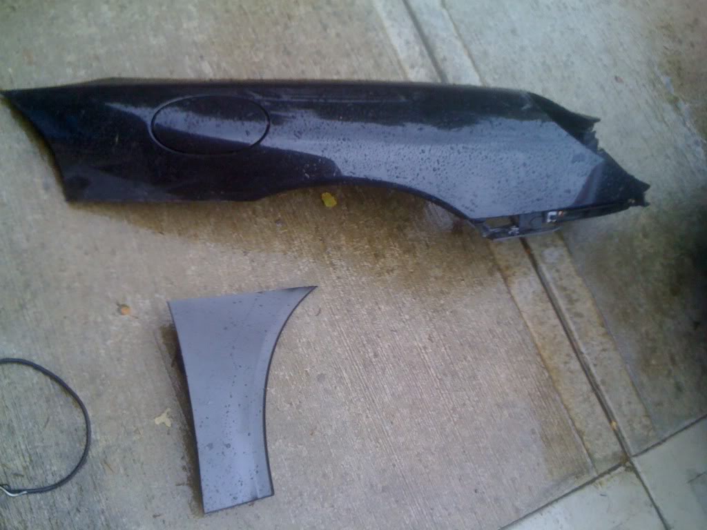

After reviewing a lot of pictures, I've decided to remove the OEM 996 GT3 side skirts.
The 997 MK1 GT3 doesn't really have a bolt on sideskirt, more of just a rocker panel type line from front fender to rear wheel arch.
The shop that made my fenders basically took am OEM 997 fender and blended it together with an OEM 996 fender to create a kind of hybrid. They then made a mold from that, so essentially my fenders have to slight 997 arch, but bolt into the OEM 996 fender mounting areas. The only thing required is a little extension piece where the front fender bottom meets the rocker area, which I already have.

I'm a bit confused as I thought you said you had the hybrid fenders with the 996 lower half. The picture you posted has the full 997 fender lines, even at the bottom.
What I meant to say was that basically my fenders bolt on, with the only thing needing adaption/modification being the bottoms of the fenders where they meet the rocker panel. As far as I know, using metal OEM 997 fenders requires one to cut/hack the fender mounting rail at the top, whereas my fenders bolt on to the rails directly with no modification at the top. My fenders are however slightly flared, which causes a need for an extension piece at the bottom where it lines up with the rocker.
As you can see in the picture, there are pieces that go over the OEM 996 rockers and allow them to blend with the line of the 997 fender.
